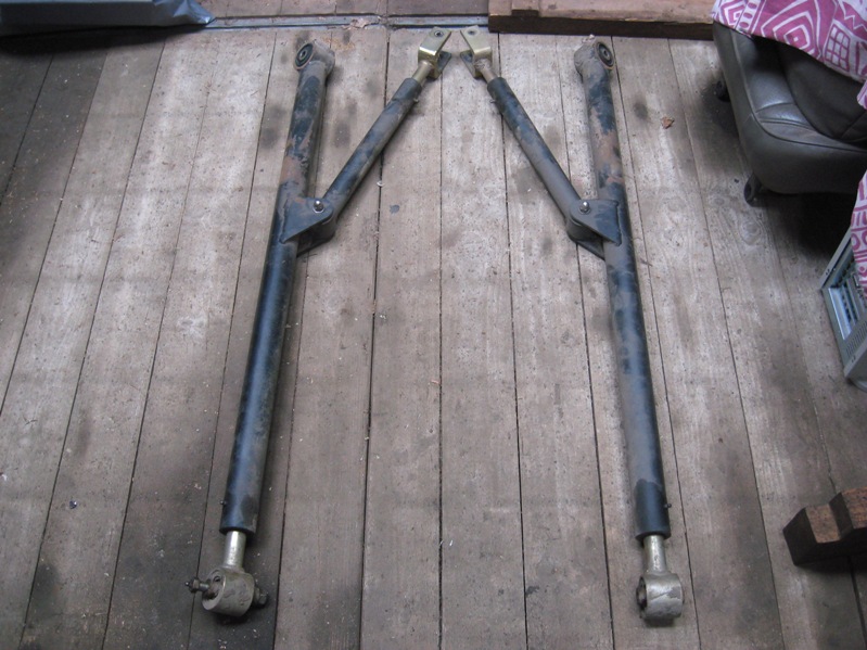

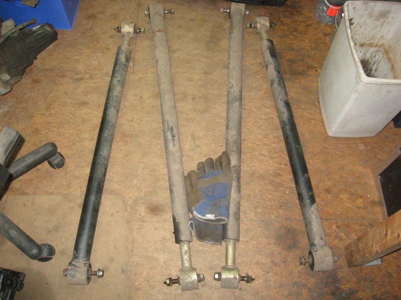

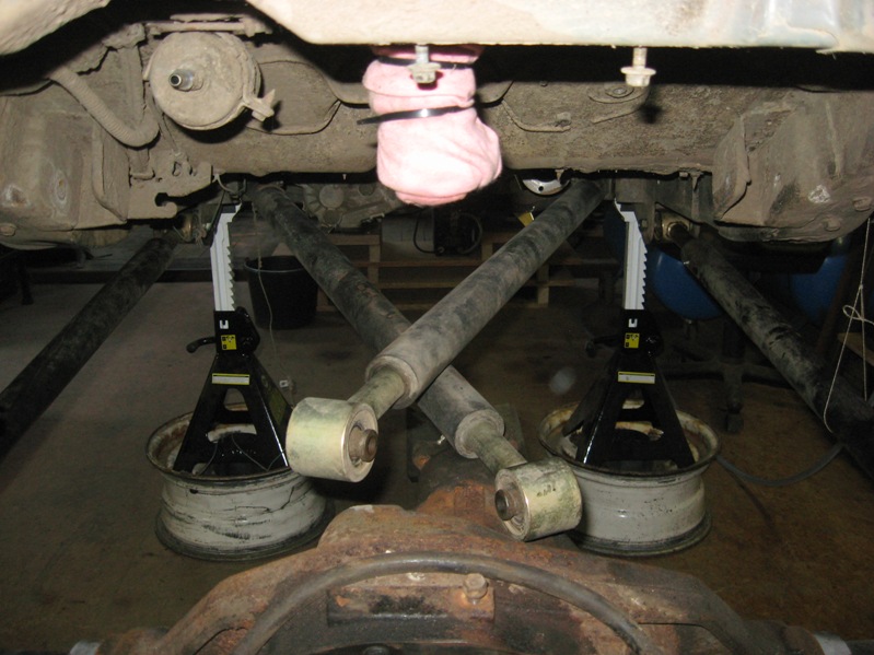

Recieved a request for my control arm lengths.
So still had a picture I took off the whiteboard when dealing with that.
In black are the numbers I grabbed from this board, green is the same as black but in metric units.
Red is what I ended up with in my built.
Cause the arms are threaded on one end, they can be length adjusted +/- 2.5 cm(1")
The tube diameter I used is 55mm(2")
Hope it helps.
The arms will be cut up somewhere next year for the 60/10.25 build.

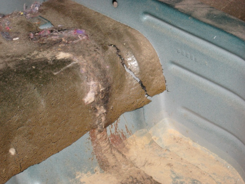

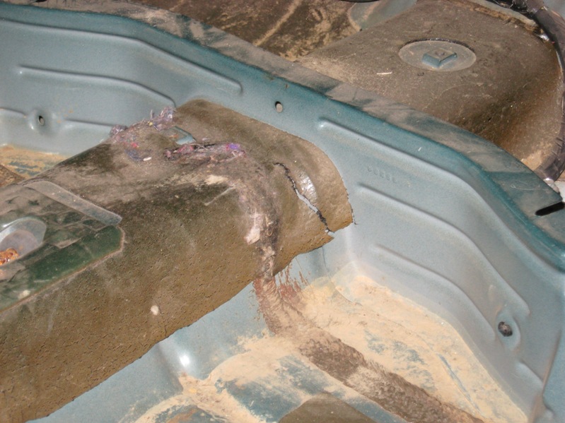

Ripped the floor, just in front off the rear seats due to flexing.

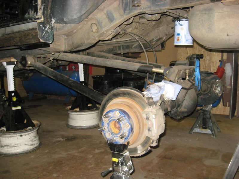

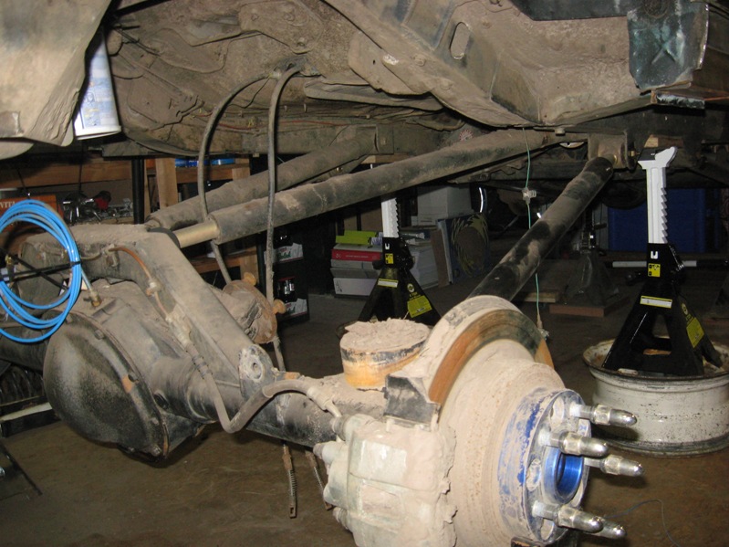

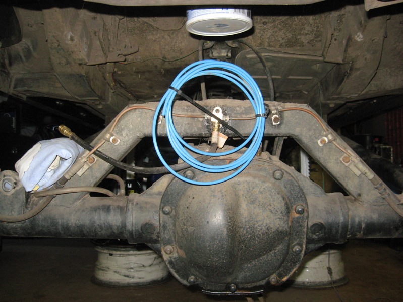

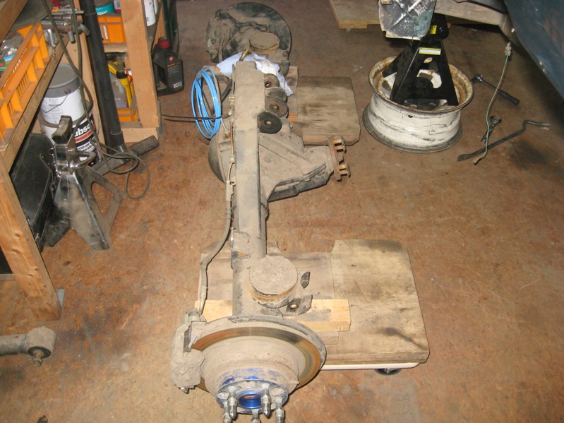

First off all taking the 8.8 out.
Emergencybrake, brakeline, airline and breather taken off.
Parts to go.
Only 4 bolts holding it in

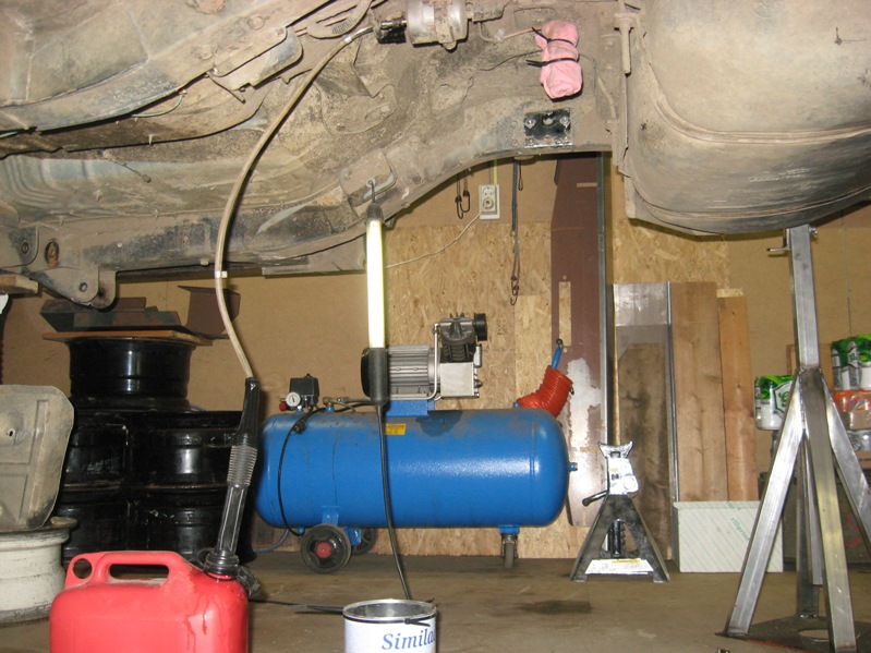

Is that a similac can? Whats that for?
Control arm's wil be reused after getting them longer.
Out

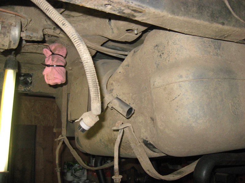

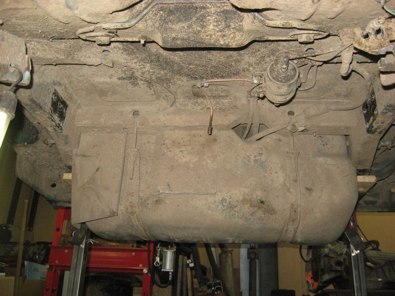

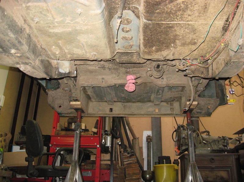

Time to empty the tank, it need to go.
Well known fuel consumption

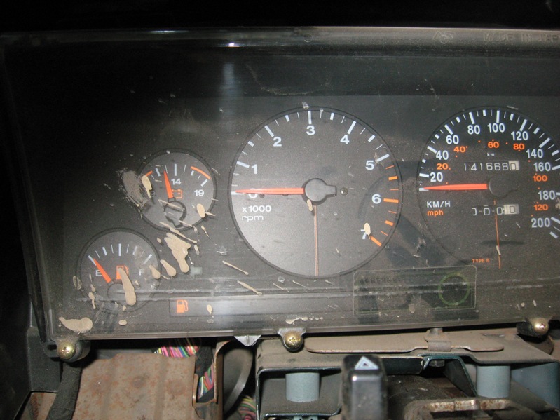

Warning light still working.

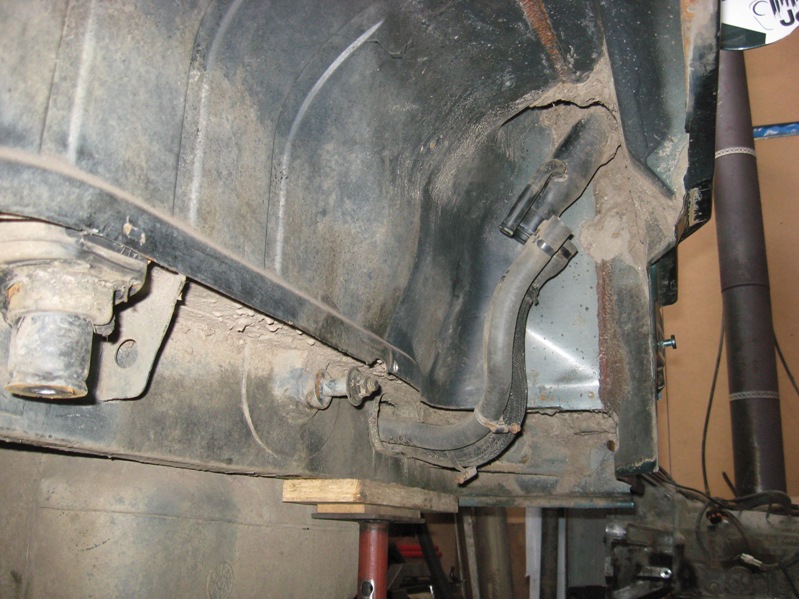

Fueltank hoses disconnected.
Connector and mounting brackets disconnected.
Completly removed.
Space.

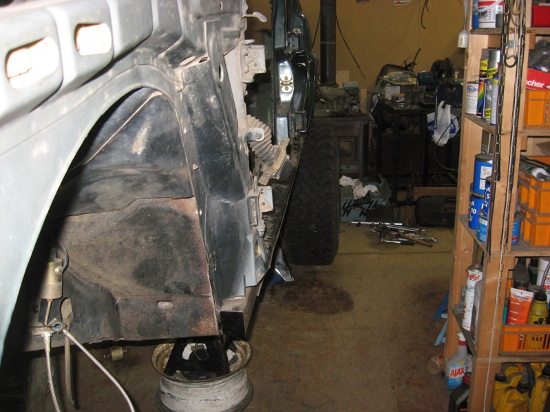

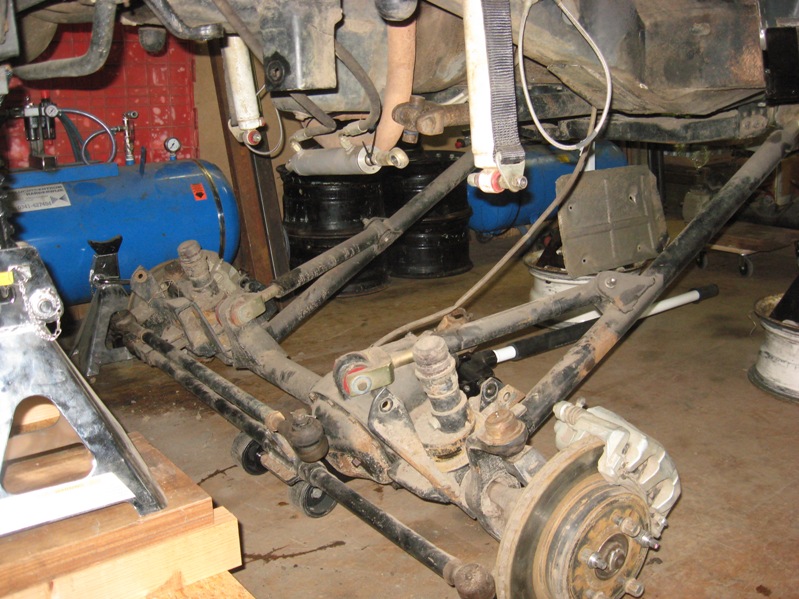

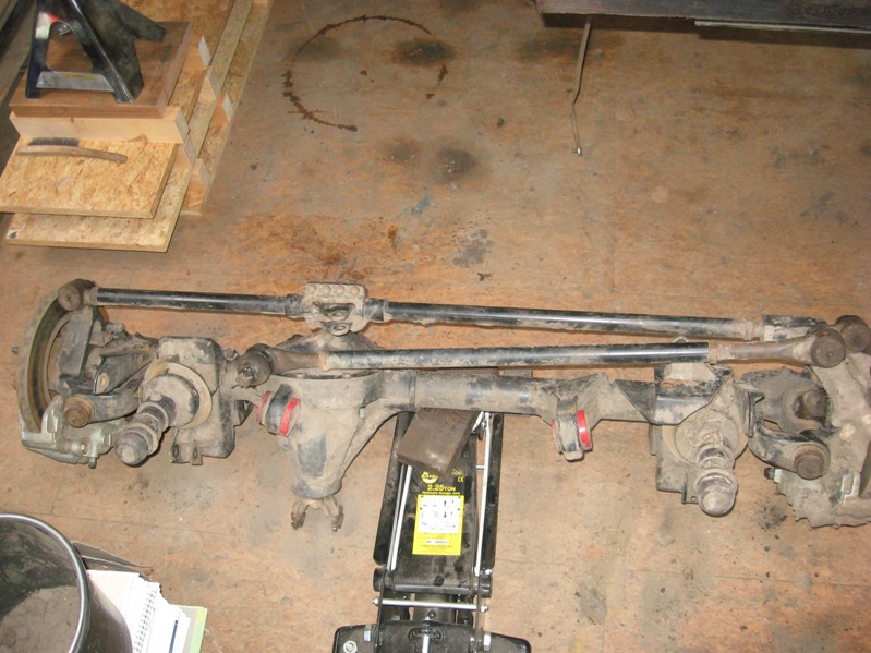

Time to take the front out.
2 Bolts left.
there it is.
The custom CA will be reused.

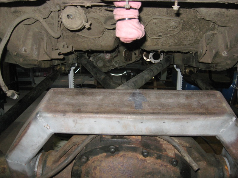

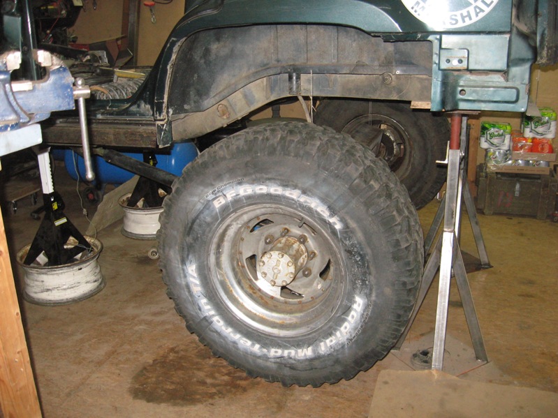

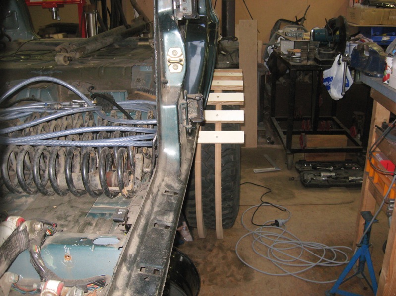

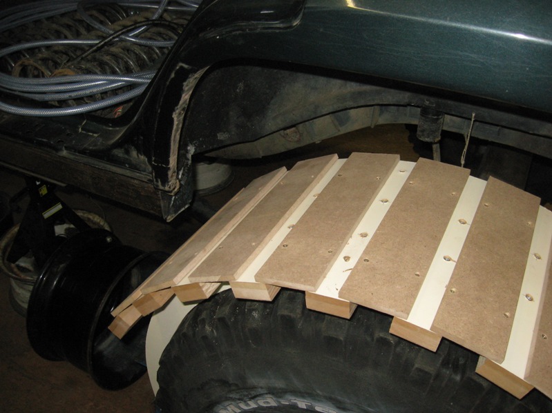

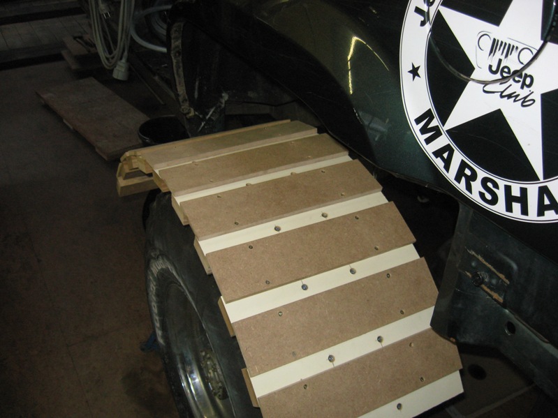

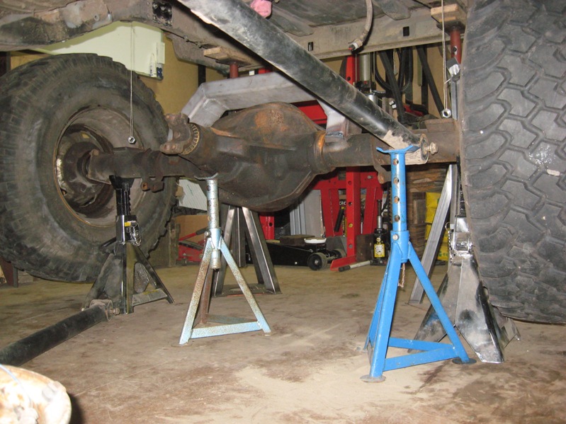

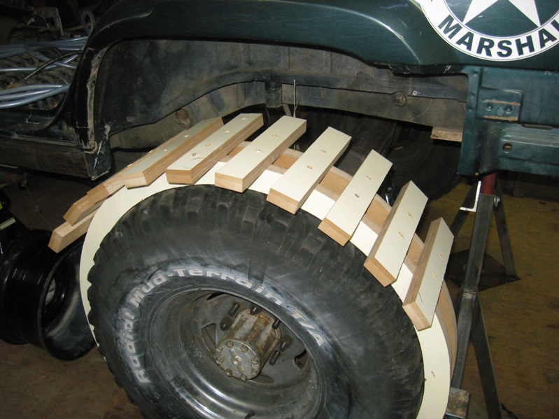

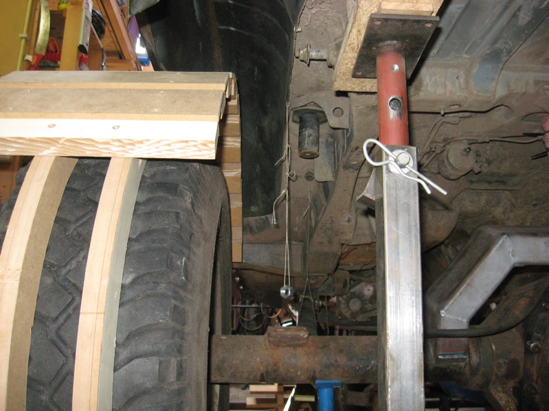

Back to the rear, mock-up of the 10.25
As a starting point, pushed the axle 3" back
This isn't ride hight, axle have to come up higher.

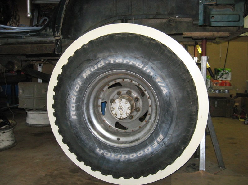

The width with these 35*12.5 tires isn't too bad.

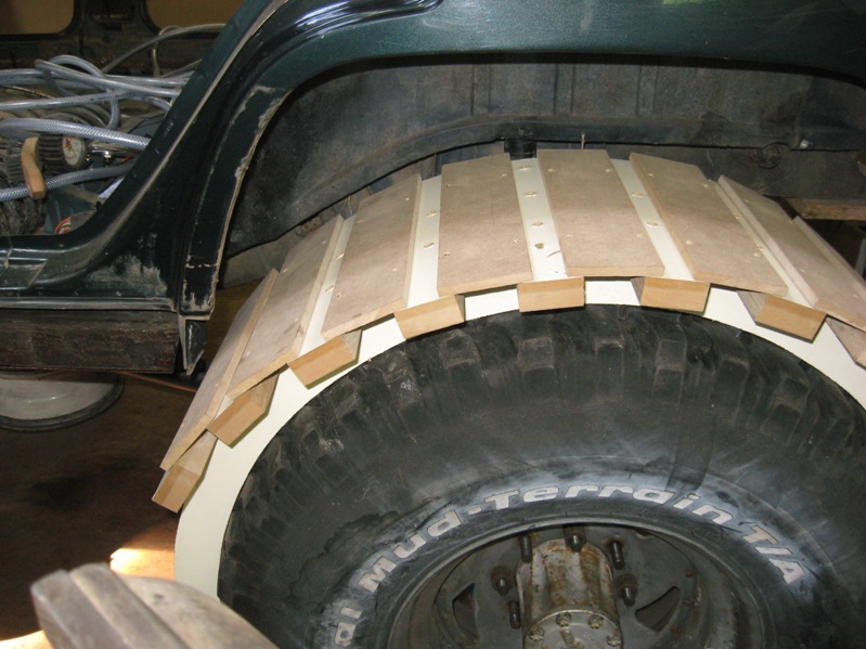

Started a "tire" template, so I can reduce on guessing numbers
Only a tire thread "print" is missing.

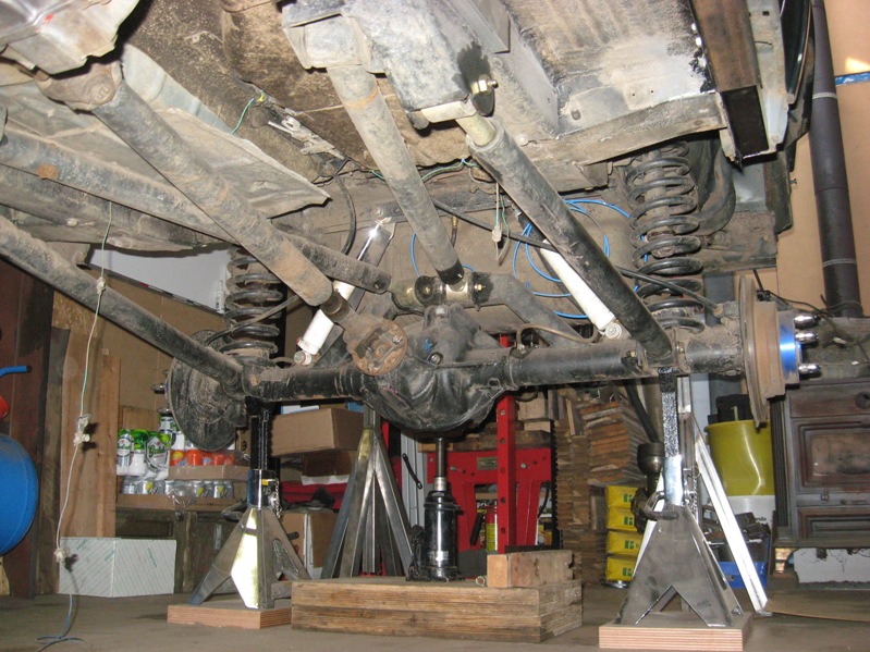

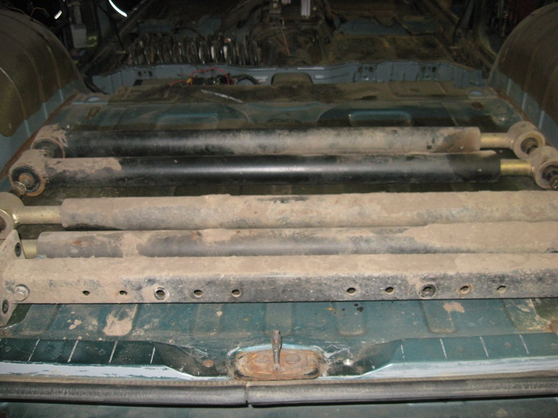

CA's back in, the lowers I just extended 1" by turning them out.
Good thing they are adjustable.

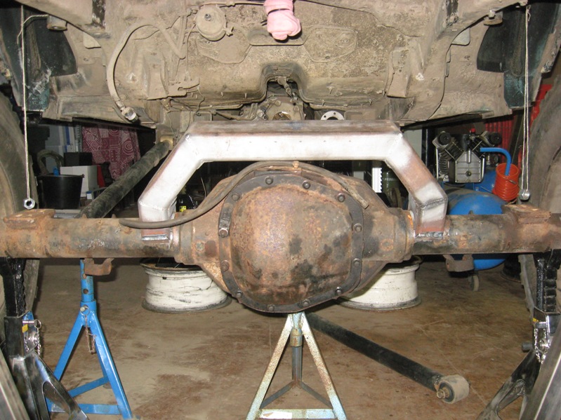

The uppers will be rebuilt to an A-frame, like in a wj.

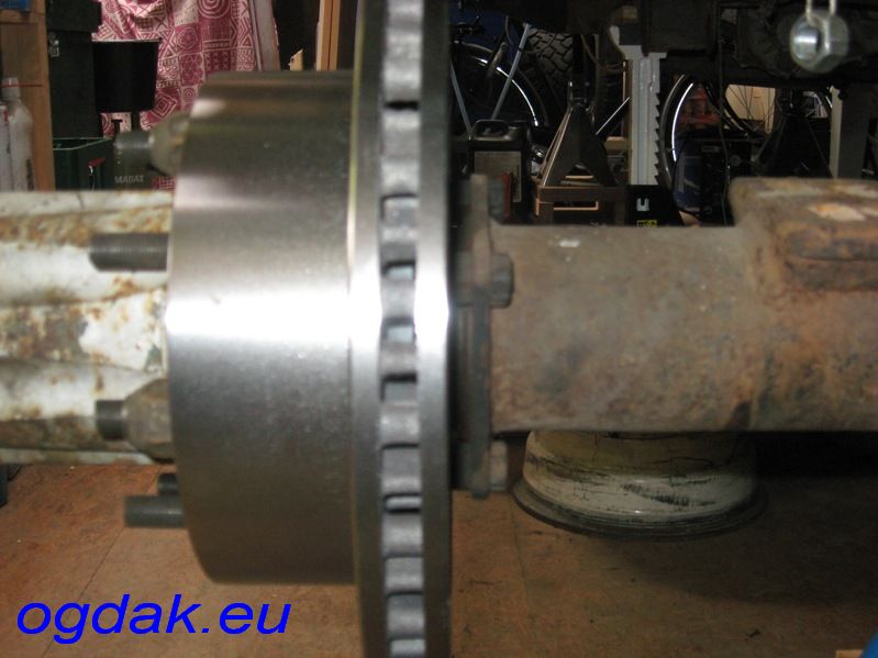

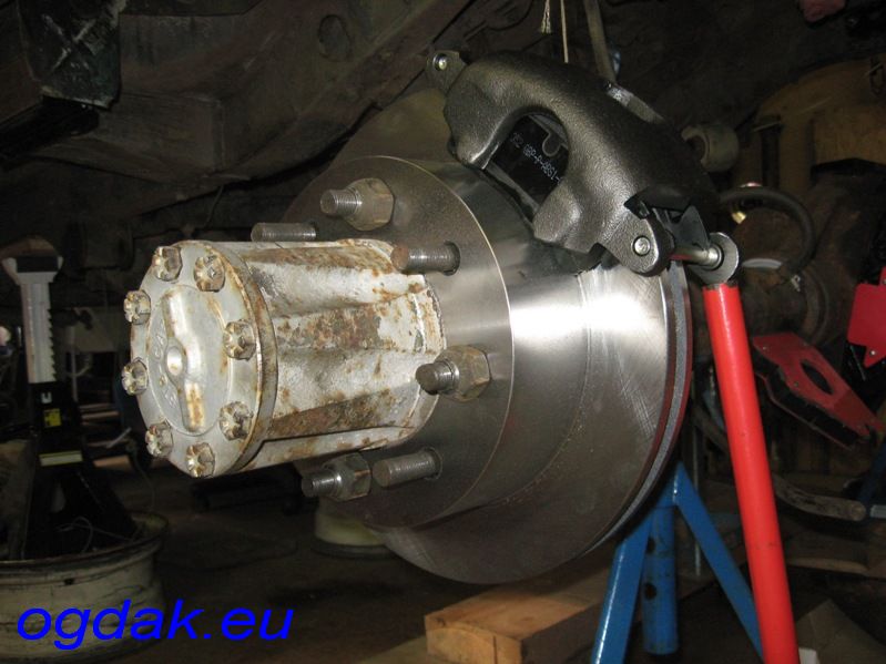

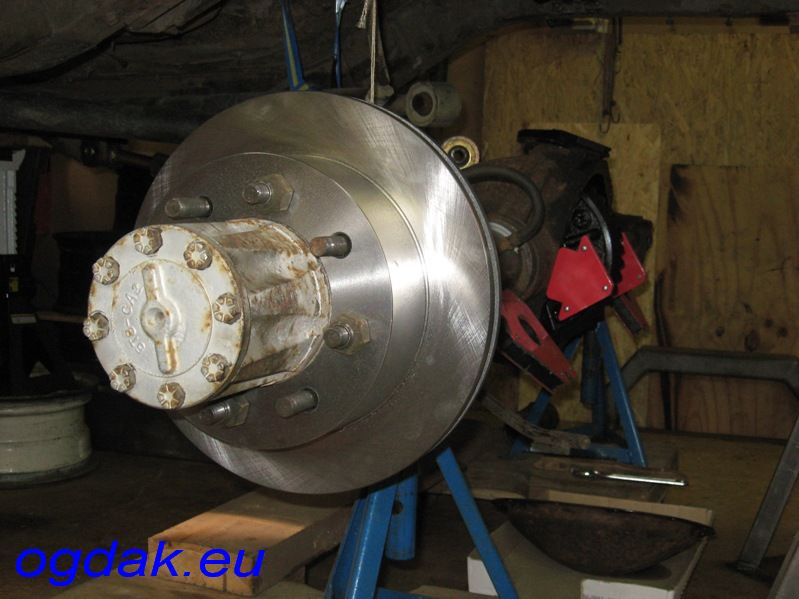

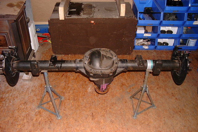

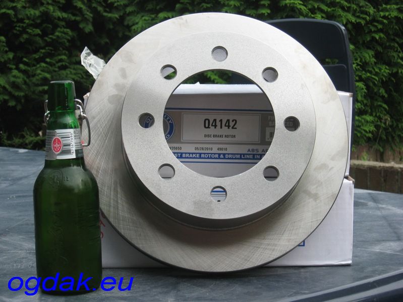

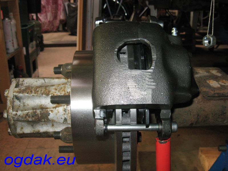

Started collecting parts for the brakedrum conversion
Rotor's from a '96 E350, over 30 cm in diameter.
Perfect fit on a '85 sterling 10.25 axle.
Front caliper from GM '73-'87 3/4 Ton 4x4.
Brackets are on it's way.
