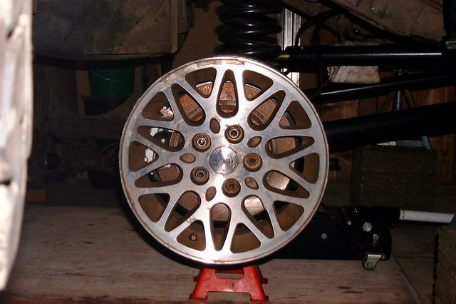

    Standard 15" 7J rim
    US wheel 15" 7J with Bridgestone AT 31" 10.5
    15" with 35"
    And hopefully the last one for a while.

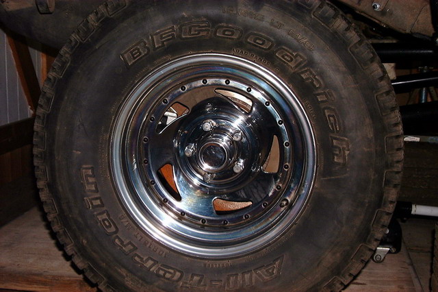

    Eagle Alloys
    SERIES 186, Super Finish, 16x10, Offset -24mm, BSM 4,5" en load 2100lbs

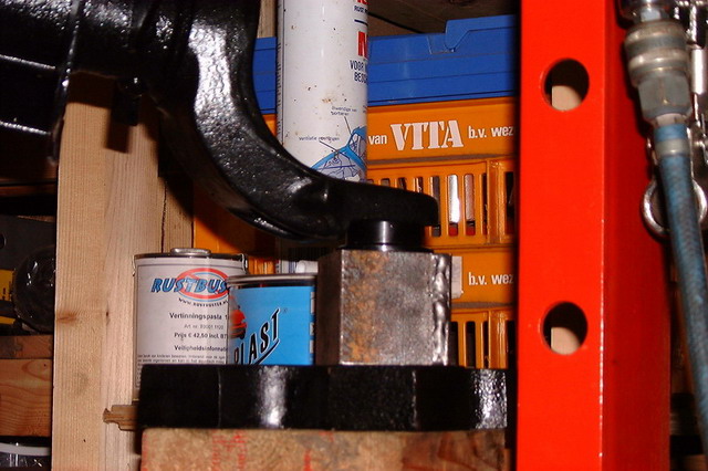

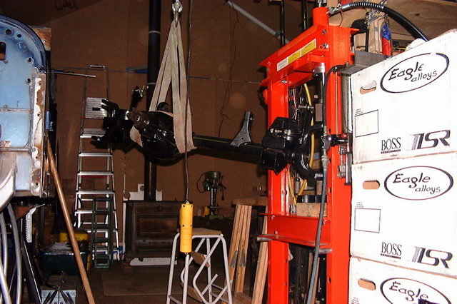

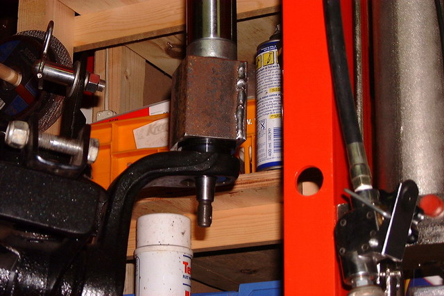

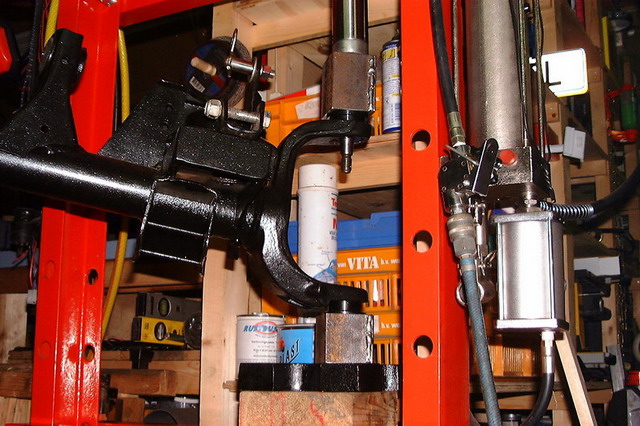

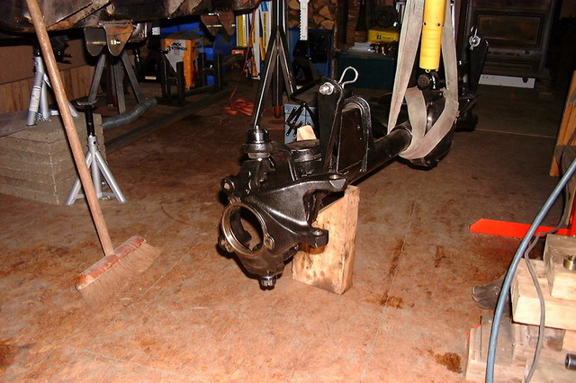

    Time to press some new ball-joints in the D30
    Making the adapters took more time then pressing itself.
    Had to place a piece of bar between upper and lower "ear"
    lower
    upper
    the benefit of a hoist
    WJ knuckle in place.

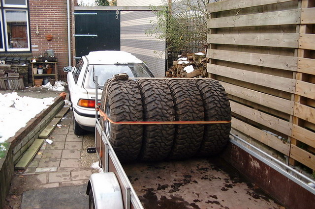

    Time to return these, thnx JeePee

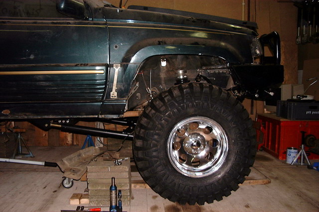

    Replaced by these

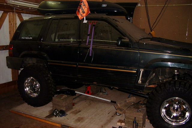

    Maxxis Creepy Crawler 8090 37"*12.50/16
    Obvious that axle is to much forward, love those adj. CA's

    Quote Originally Posted by ogdak
    Actually it is not... Just cut a little on your bumper and fender, and you'll have a much better aproach angle. About the WJ knuckles... nice work, looks good. But I think it was a waste of time and money. With that lift/tires you are past D30 terretory.
    Anyway... your doing clean work man!

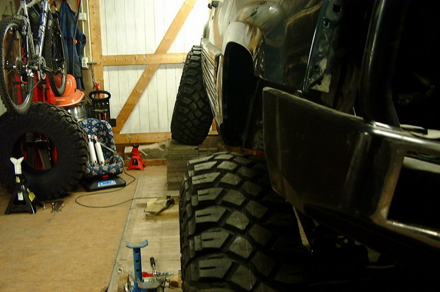

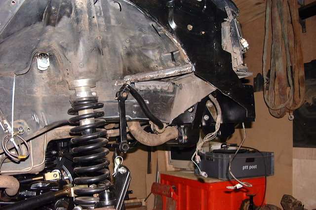

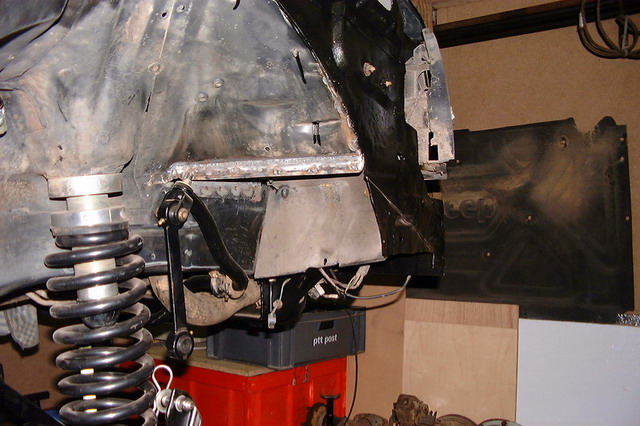

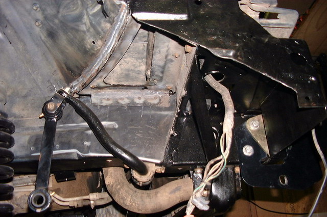

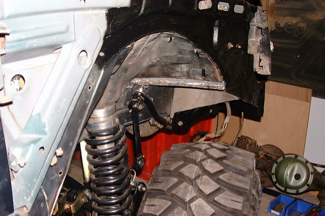

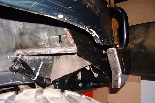

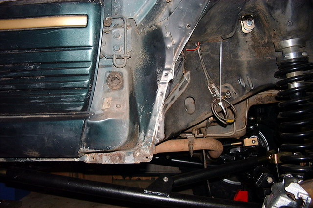

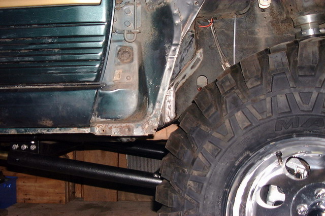

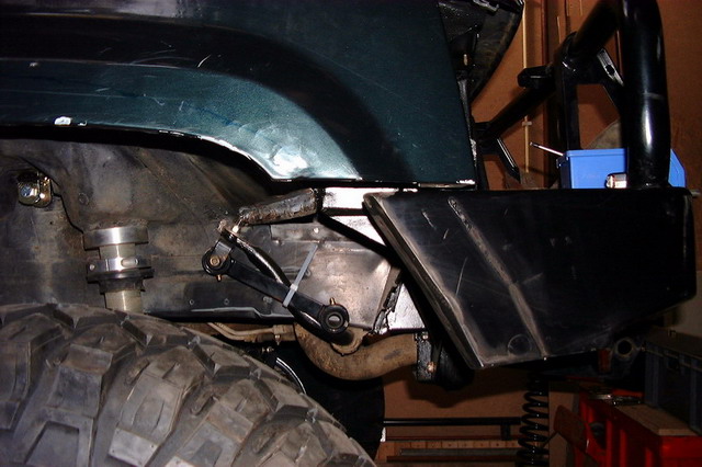

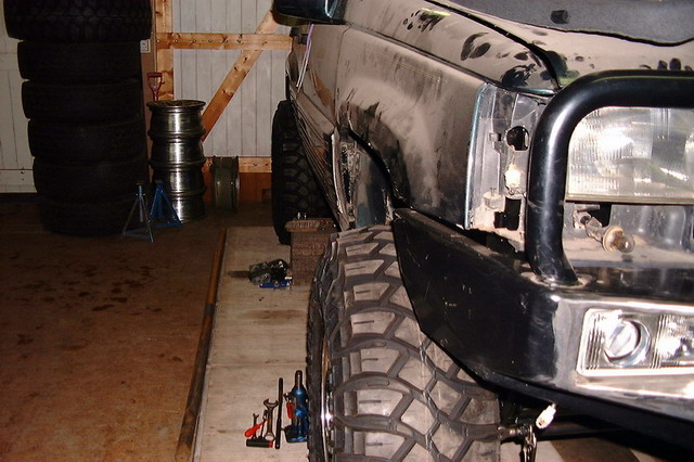

    Because off the bigger wheels/tires I need to create some space in the front wheelwells.
    How? well with a cut-off wheel.
    Mainly on the front
    On the back off the front wheelwell only minor adjustments.
    stock
    cut
    Space enough

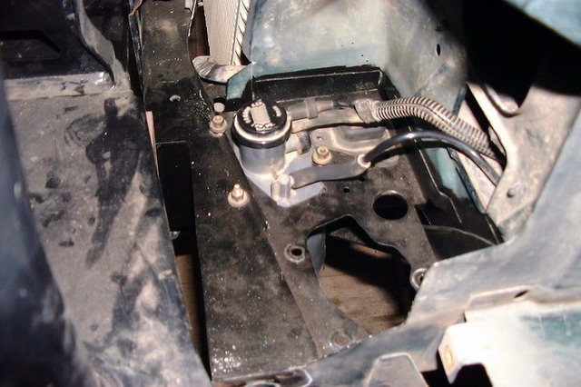

    Reason why the inside rear-view mirror can go

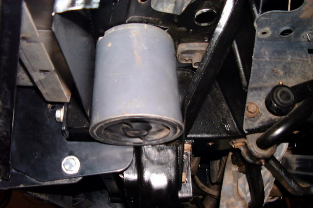

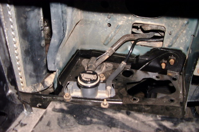

    The evap canister has to be moved also.
    The rightside mounting point is the stock location
    From below, outside the reach off the left front tire.

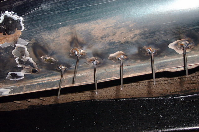

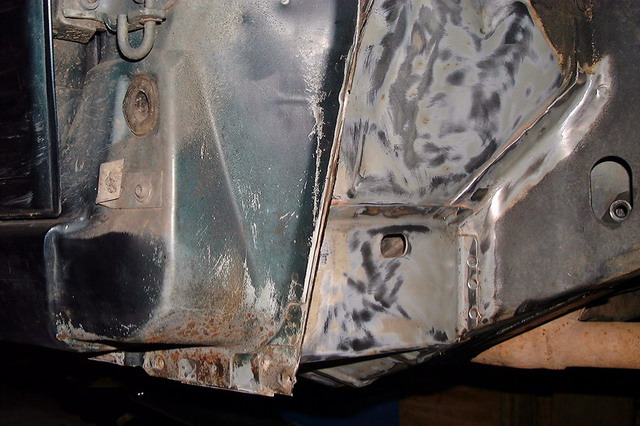

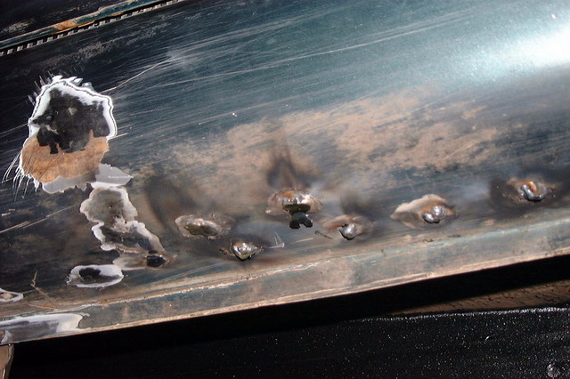

    Front bumper sides shortend about 2"

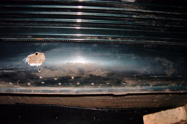

    Because I had damaged my rockers in the past.
    Drilled a bunch off holes to restore its original(more or less) shape
    And plumbed the holes
    Took the grinder.
    And done for tonight.

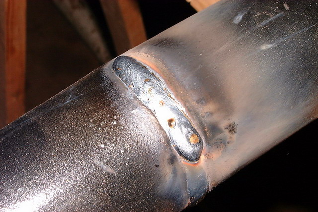

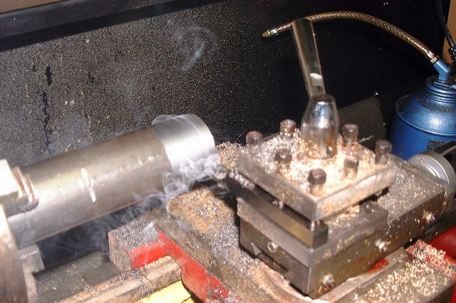

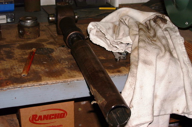

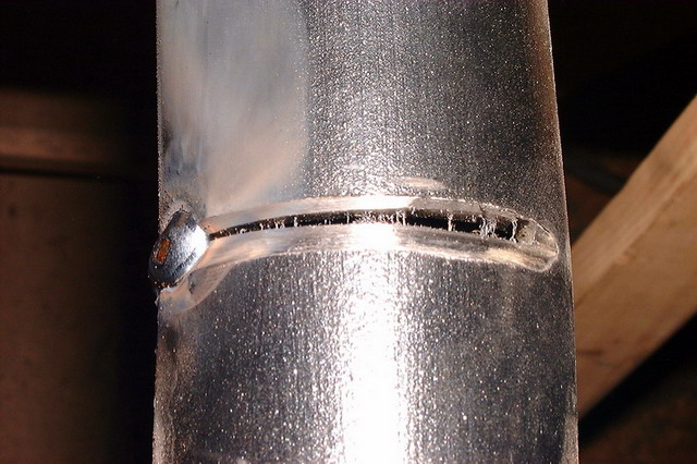

    To be precise, with a stock front DS which is now almost 4" short.

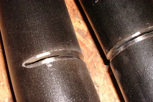

    So I cut it in half

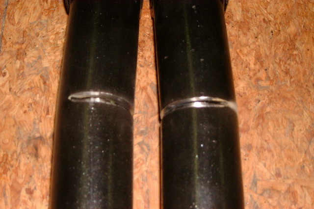

    Took some solid bar, 6" length almost 2" in diameter.
    Took some off on both end's to match the inner DS diameter, which is 39mm.
    Used the press and welder to get things together.
    DS still needs to be balanced, then I'll know wether this will work or not.
    Do not have anymore pic's off it.

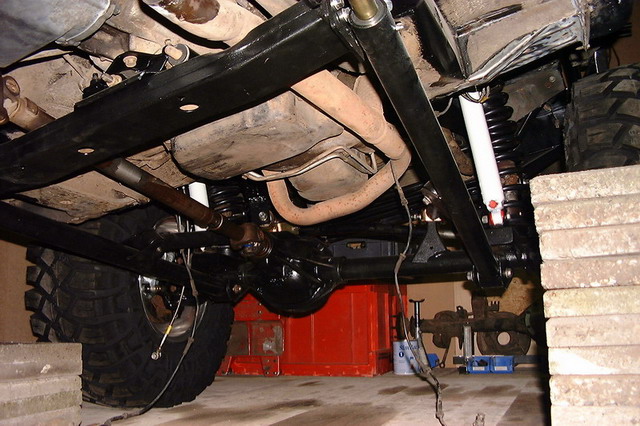

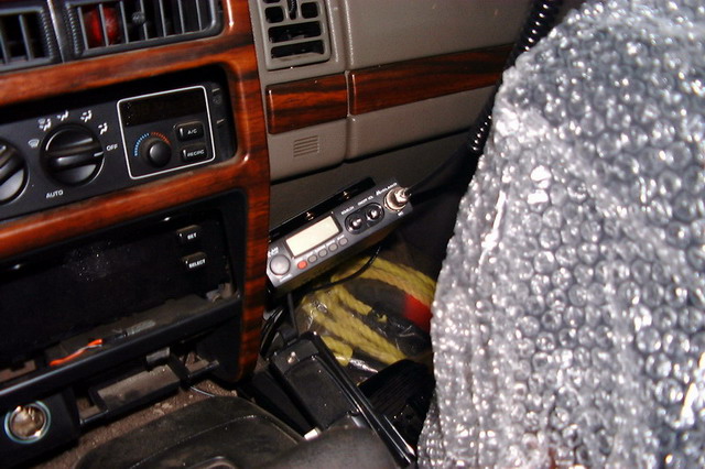

    So finally it is 2006.
    I plan to drive my ZJ this year, big Q is WHEN

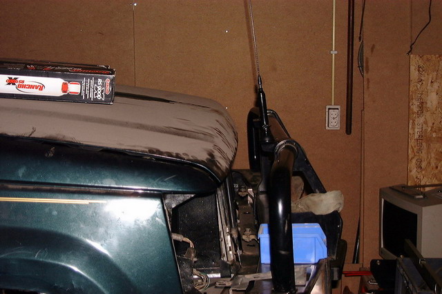

    Starting with CB and antenna location

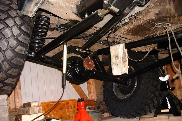

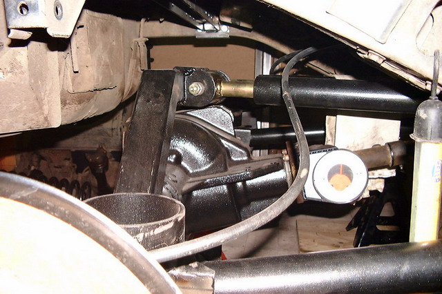

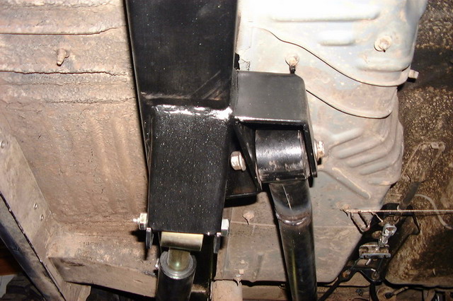

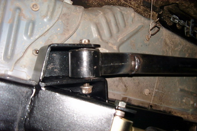

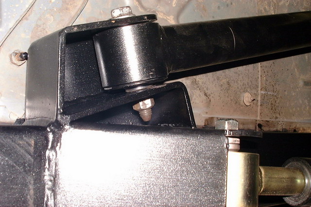

    Not even completely done, I already need to change something on the RUCA
    The angle off the frame side bracket is not inline with the CA's
    So cut the arms for about ¾ off the ø
    Some extra grinding
    Used the press to get the right angle, approx 5 degrees and welded it up again.

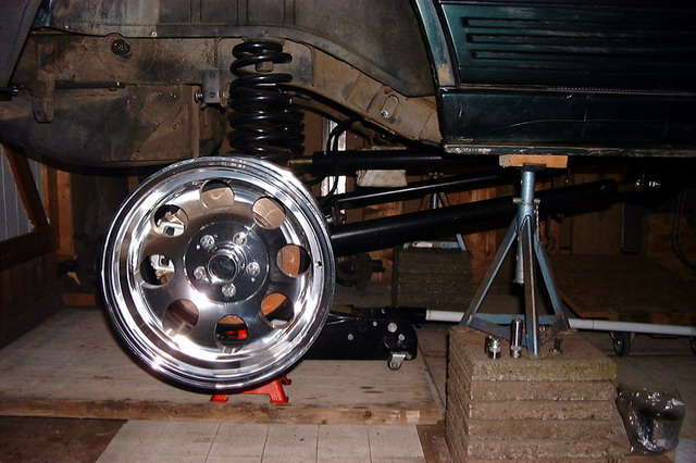

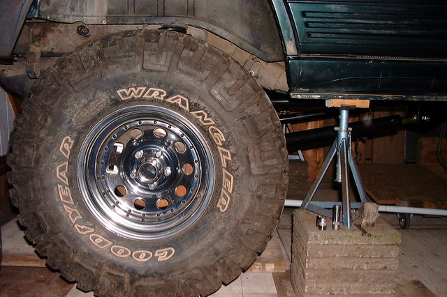

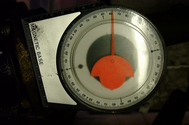

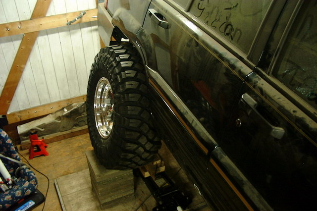

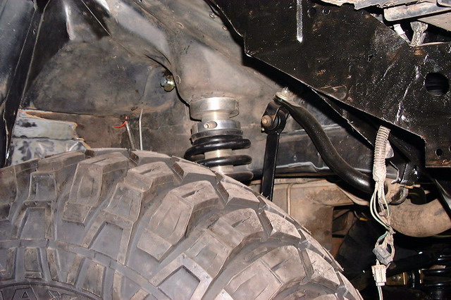

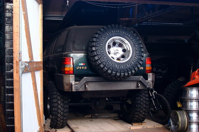

    Dry practice in the garage, turns out I hit the rear coil with me wheel.
    So ordered a set off 1¼" wheelspacers.
    Setting up on the rear.
    12 degrees
    All for now.
