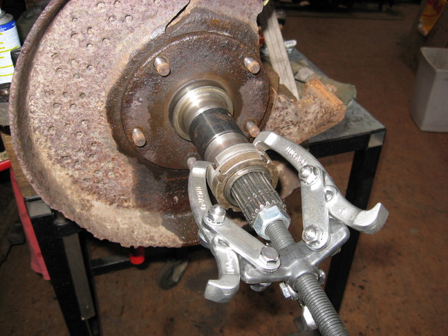

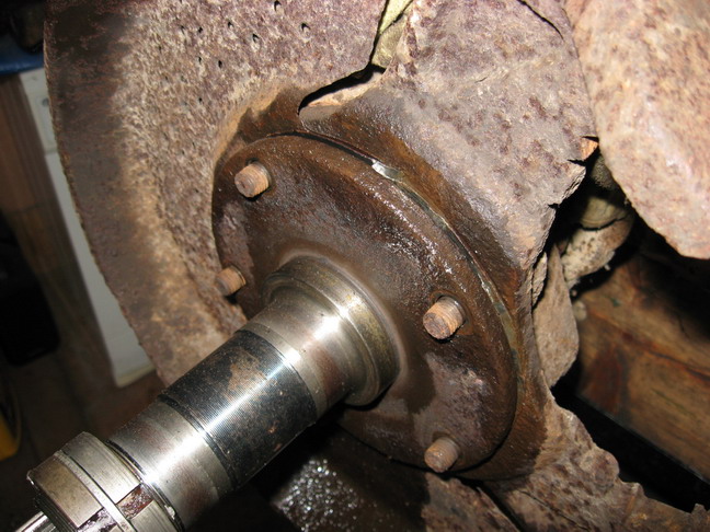

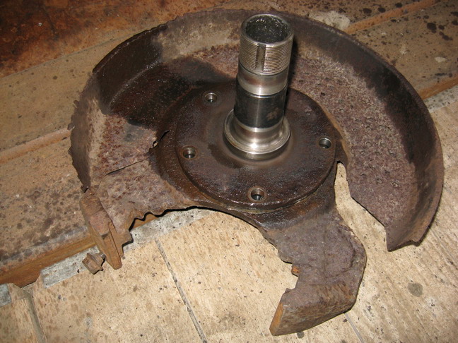

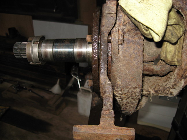

On with the hubs,
Used a puller, a torch and sacrificed a chisel.
bit by bit
finally, complete with brake anker plate

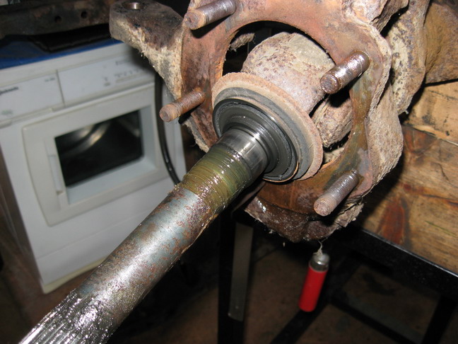

Time to take the axle shafts out.
On to the outers,
Steelbrush, wd40 and air impact gun.
Came loose pretty easy
Can't reach the lower one with the impact.

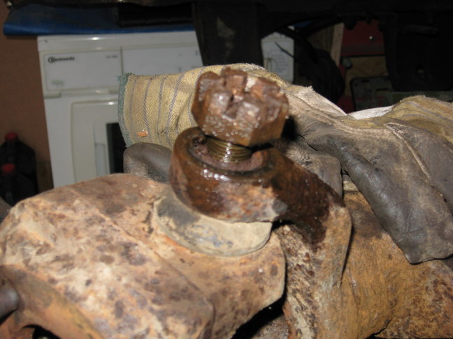

So I nice tap from the sledge on a wrench did it.
3 firm blows on the top castle nut were enough.

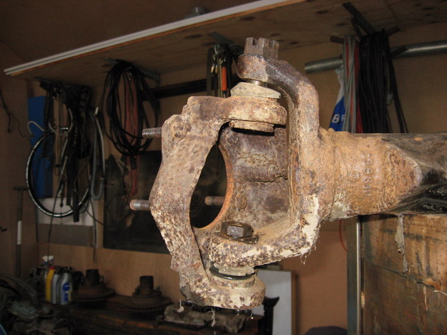

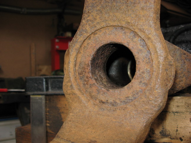

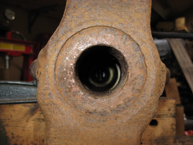

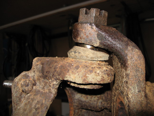

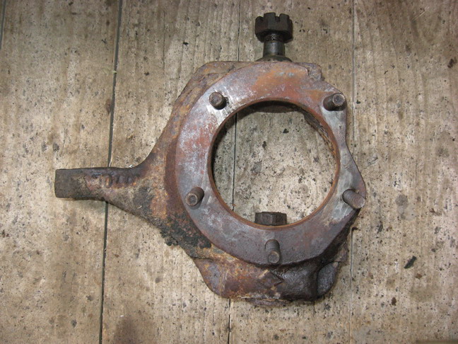

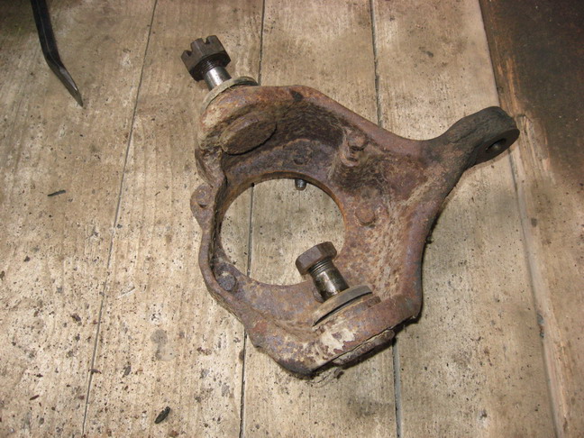

One off the big differences with the D30 outer knuckle,
On the D44 the balljoints are pressed in the outers, while
on the D30 they are pressed in the inner C's.
I like the D44 solution better cause when replacing those joints
it's easier to put a knuckle under the press then an axle.
A ½ ton flat top knuckle, not the best option for hi-steer arms.
Tappered adjuster on the inner C, time to make another tool.
Axletube, dia 7.5cm wall 1.5cm
Taken apart, the diff is still in, not in my way for now.
All for now on the High Pinion D44.

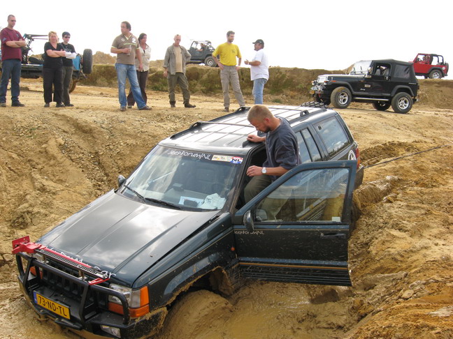

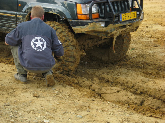

Stuck in a mudpit, thnx Dez. for warning me.
Rescued bij Dez.

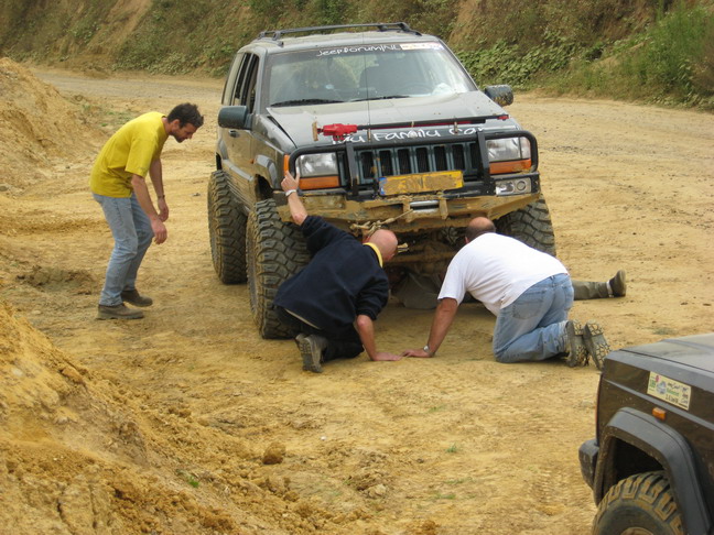

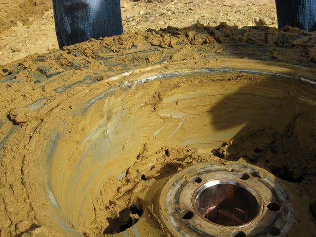

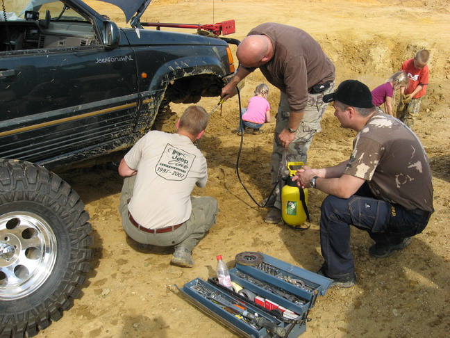

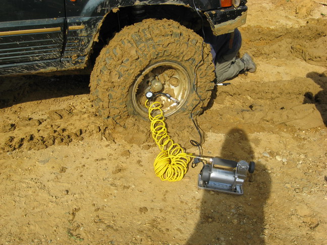

Out of it, somebody told me I had a flat
Jacked it up and hooked to Dez's compressor.
Didn't help anything so got to change and inspect it.
Her's the leak, the rim has a crack in it.
Most likely a stone got caught in between the caliper and the rim.
A little cleaning up
Kids didn't mind the delay, they where "claying on the Jeep".

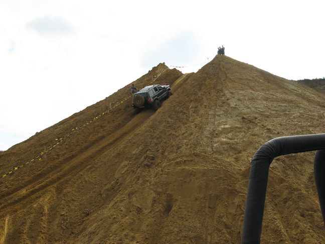

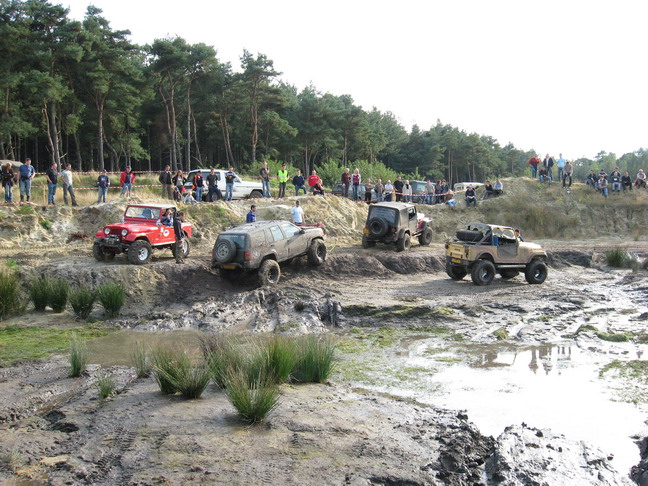

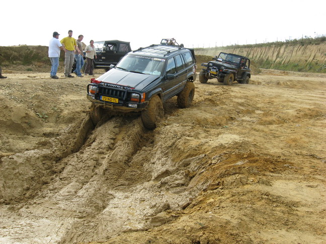

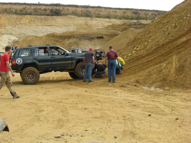

On sunday we had a Hill-climb. And since I never did that before I tried it.
Didn't do to bad for a 5300 lbs rig.
On the 3 and last attempt the front came loose bumping in the wholes from my previous run,
hitting the ground again it just "cracked". Did sound kind a familar
After drivin in Hi and Lo a bit, the sounds didn't return.
So went to do something else.
A first attempt with some stress on the front it "cracked" again.

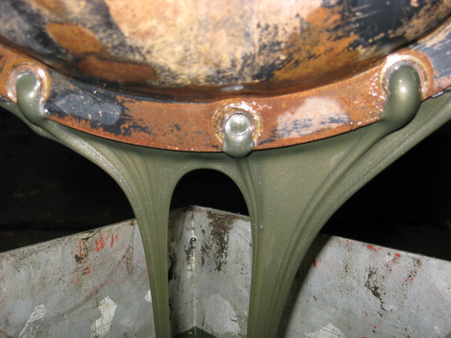

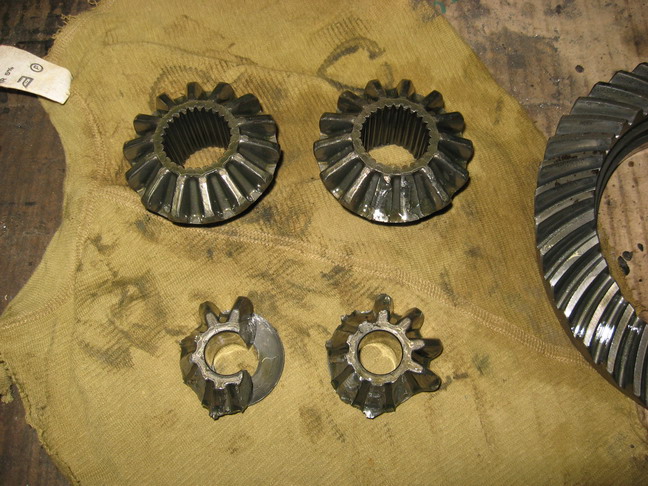

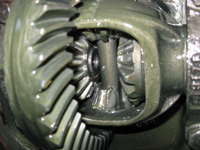

So last night started to take things apart,

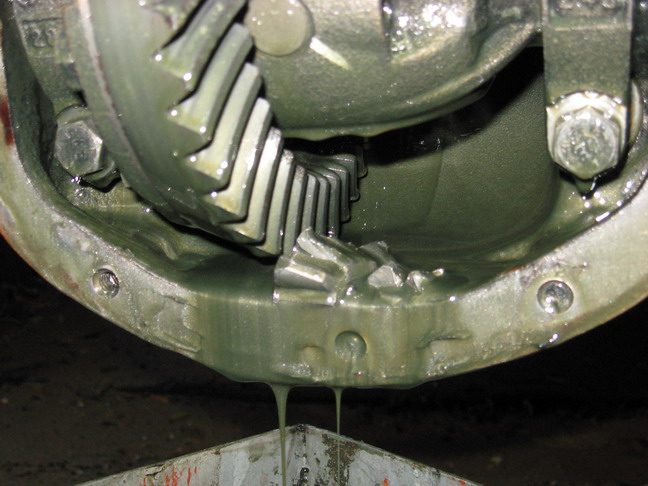

starting to get used to metalic diff. oil
small pieces
That lower sat. is almost half gone.
So 3 out of 4 sat's are damaged, R&P looks to be fine.

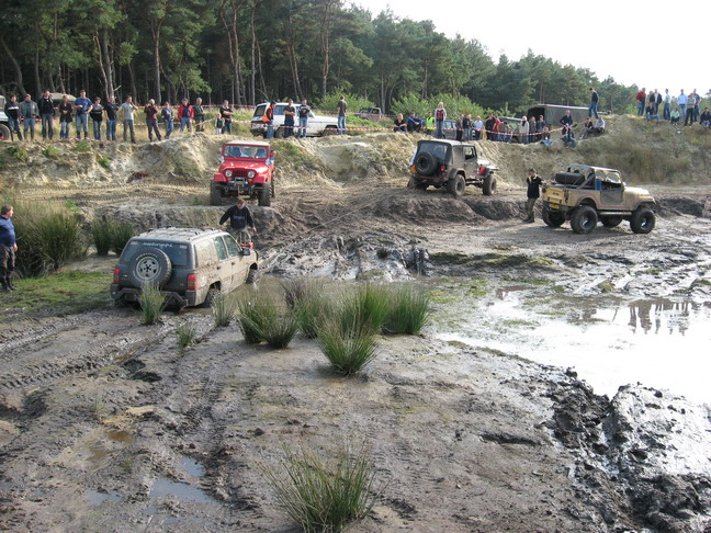

So we made a trip to belgium the last weekend off september,
This was the 12th annual in a row it's like a fundraiser.
http://www.4ft.be/index.php
They collected close to half a million euro's over the previous editon's.
Last year over the 2 weekend days over 1700 off-road vehicles attended.
Swapping wheels in the rain sucks.
it kept raining.

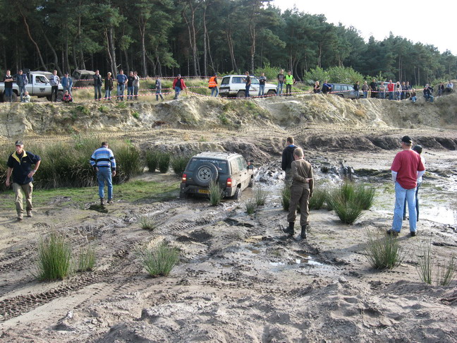

pulled out off a mudpit by a tractor
Sunday the weather was nice, trying to cross something wet and muddy.
Saved by Edwin en Willem, thnx.

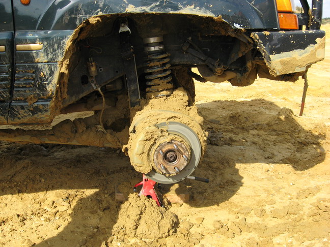

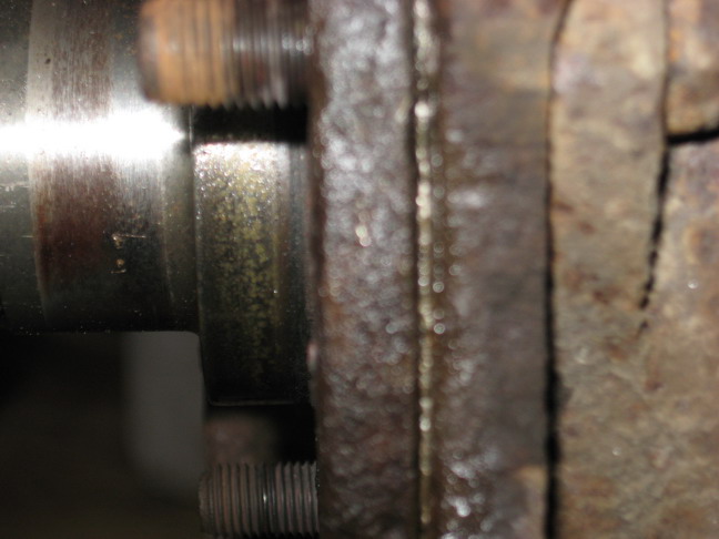

Then sunday eve on the way back, doing approx 45mph I lost my left front wheel.
This damaged my wheelstuds and the rotor.
Long story short, friends of us who we where with, drove on home.
When they got home the removed a wheel hub from Kameel's Tj and headed back to belgium.
So swapped the parts and we could continue our way home where we finally arrived in the middle off the night.

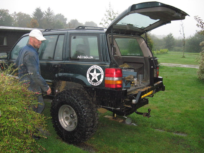

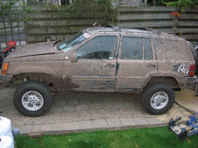

Cleaned it up,
not to bad from a distance.
but here and there missed some spots's

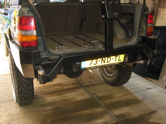

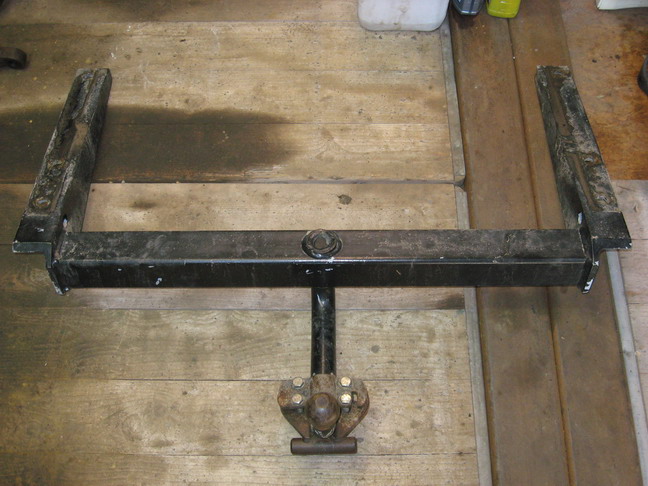

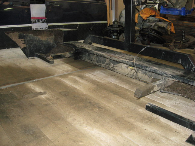

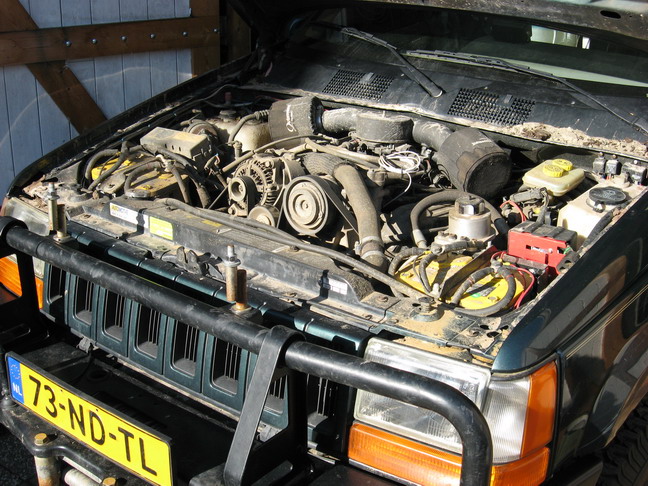

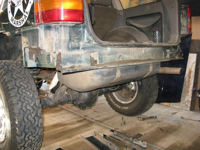

Made a start with removing things,
also the rear carrier got to go.
took on a lot off dirt in it.

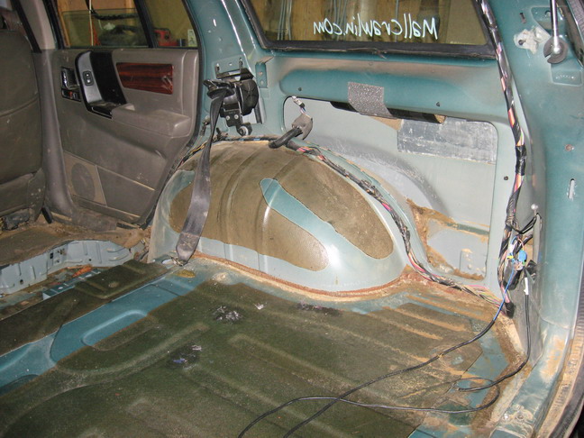

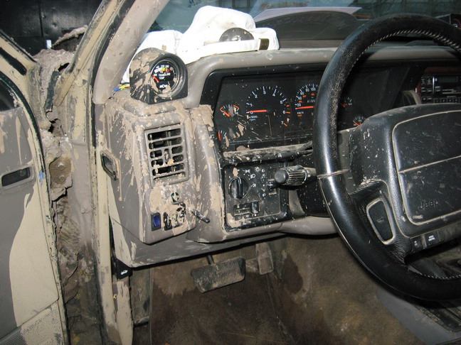

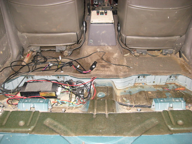

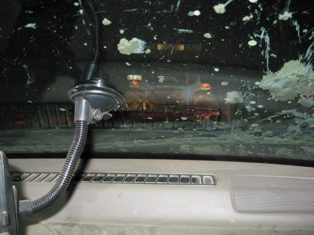

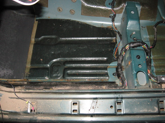

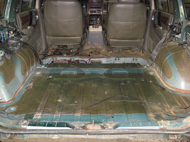

Continued on the interieur and wet carpet.
Wow, some space in there.

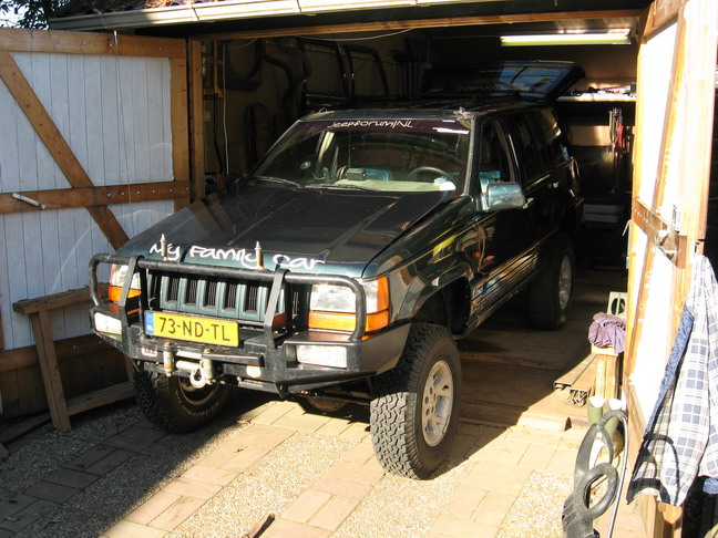

Got it suspended for road tax yesterday, that means from now on need to keep it on my own property.
Normally it costs €68.00 to suspend it, but because it was less then 1 year from the last
time that I suspended it, it cost me €113,50 . On the other hand I save €78.00 a month
for not having to pay roadtax now. Time to start saving for goodies.

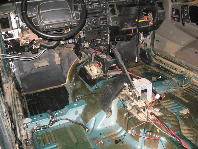

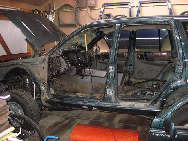

On with taking things apart.

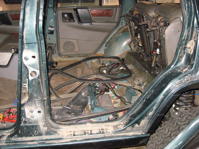

Took the doors out for easy access
Before you know stuff stats to pile up again.

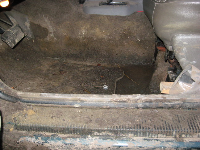

Carpet is out, the foam undernaeth it already started to smell bad
Not very clear, but it is wet.

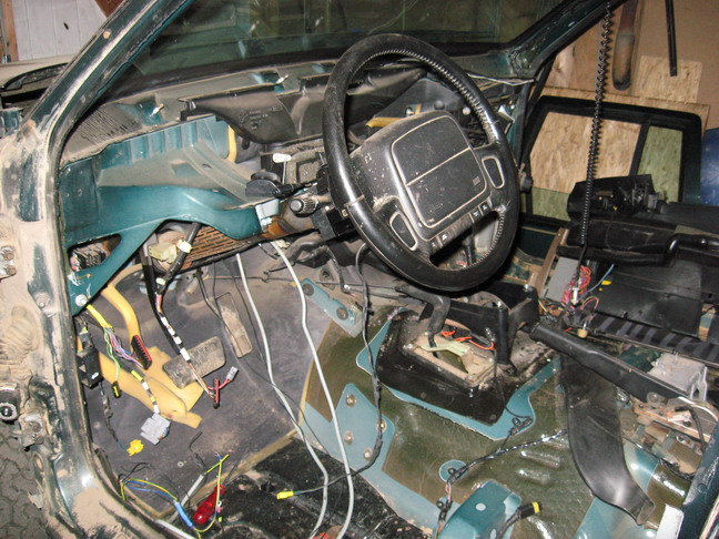

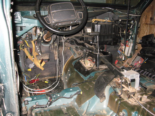

Dash is out

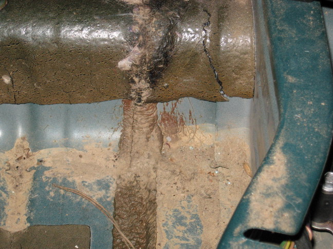

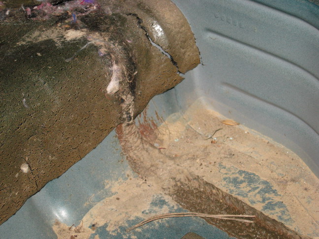

Found some ripped seams between diffrent body parts.
Caused by flexin it in terrain I think.

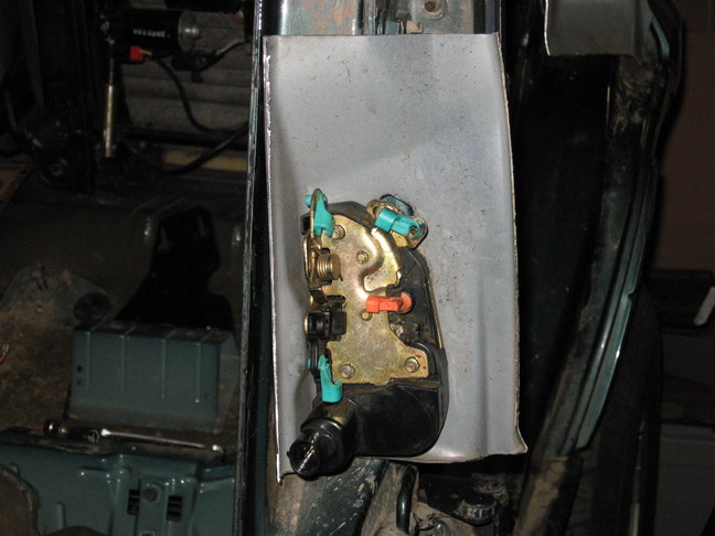

Also started on modifying my donor doors.
Don't realy have a tight plan yet , for sure though the 44/9 combi
and reducing weight .

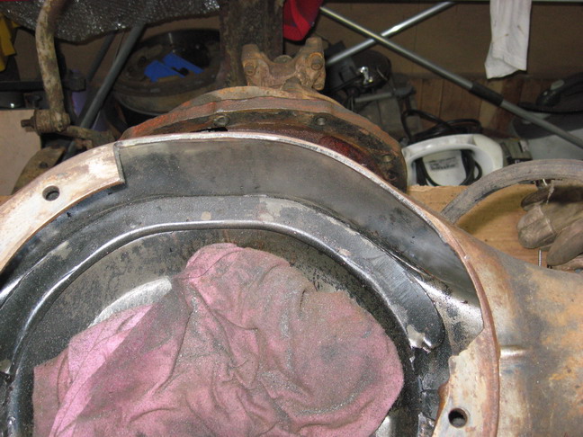

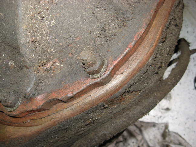

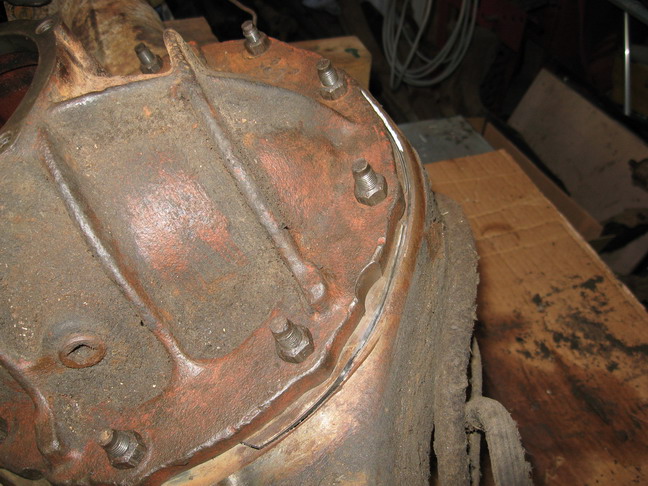

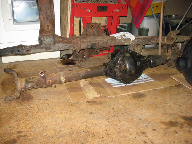

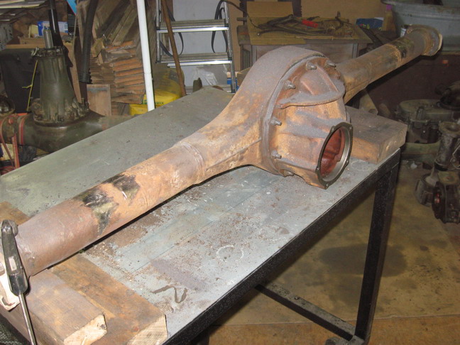

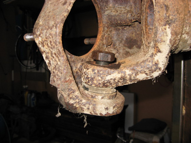

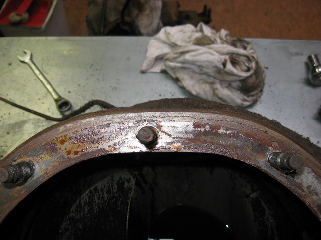

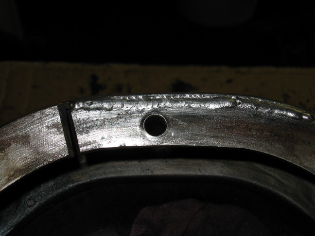

Started to take apart de 9" a while ago.

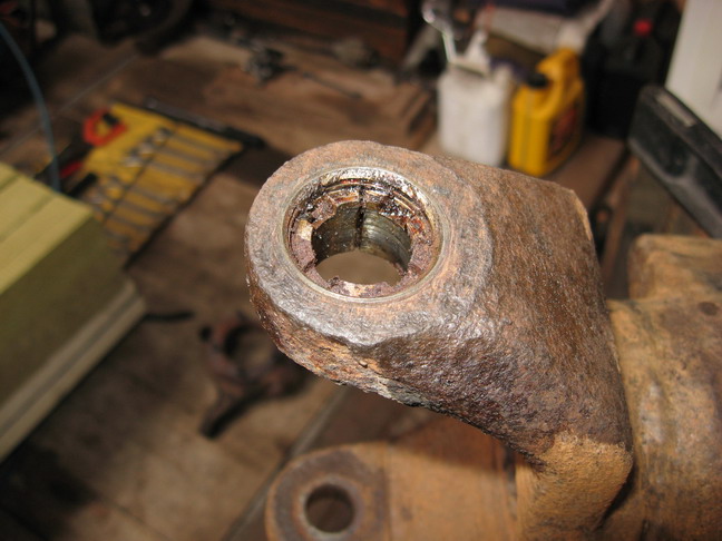

Taking the old rtf off, noticed a fine crack
After pulling the 3 member.

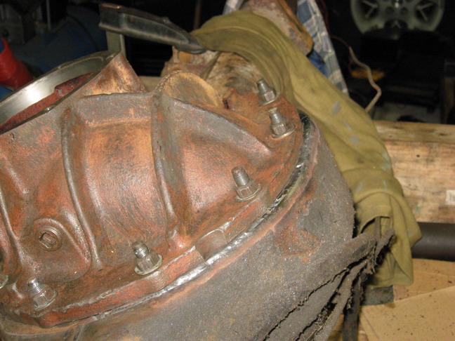

So recently decide to take a shot at it
Cut the damaged part out and did some grinding on the edge.
Put it back togeteher and lined it out.
Welded
Curious if and how long it will stick together.

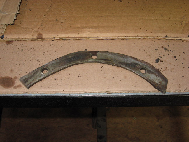

Took the stock bracket's off.
Mheanwhile on the look-out for a spare 9" housing.
