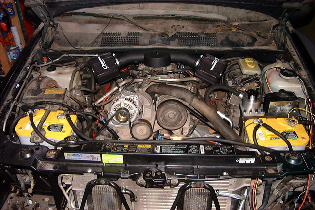

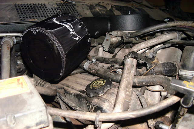

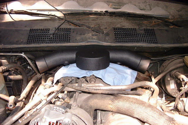

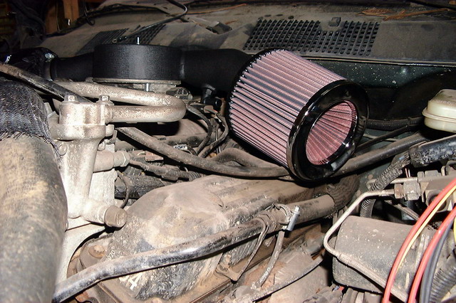

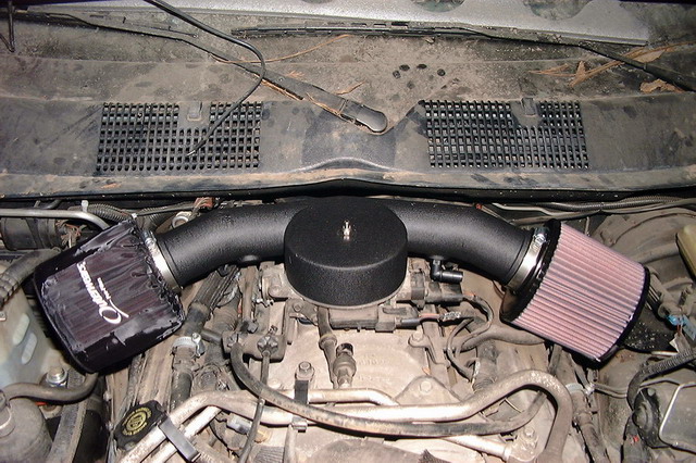

Finally got the airintake done
Cause the lack off space in the engine bay, the stock airbox and intake had to go.
So I put a "Dual air tube intake" in.
With filter,
and pre-filter.
Looks like this.

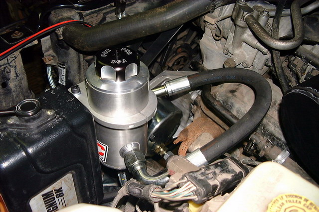

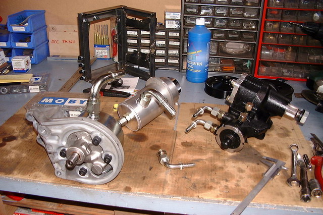

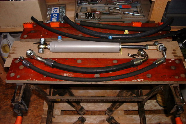

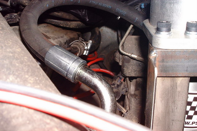

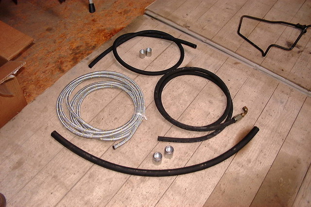

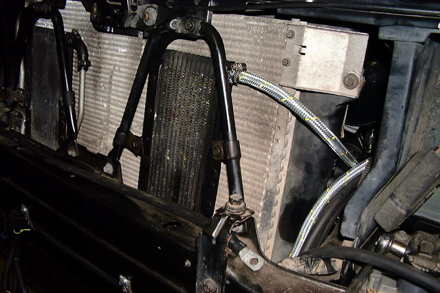

Made some progress on the steering with some 90 degree connector's.
tubing.

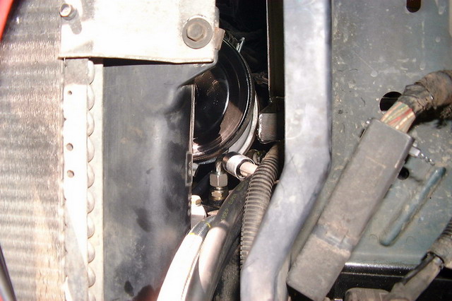

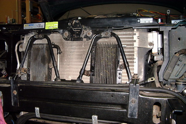

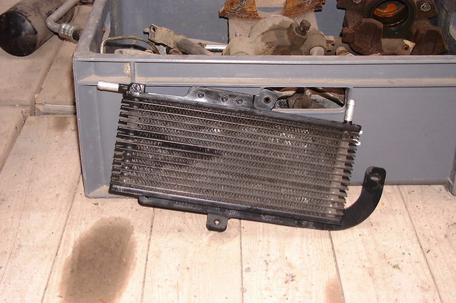

An used trannycooler which from now on will be a steeringoilcooler
Next to the stock tranny cooler

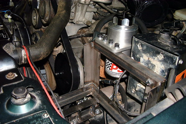

Trying to fit everything together in a limited space.

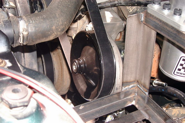

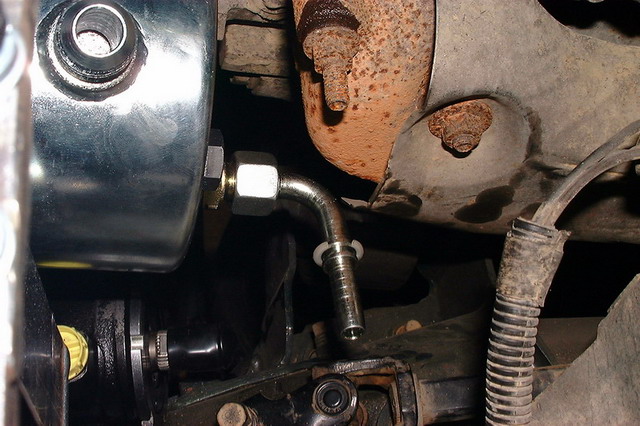

Well it doesn't fit. Not enough "height" between steering gear and powersteerpump.
So had to cut that nice and shinny do.ge du.angry bracket from the bottom, but still not enough.

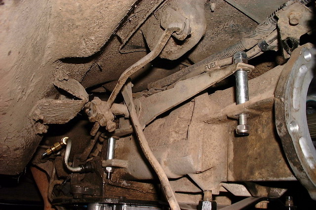

Thankfully over a year ago I made an adjustable tranny traverse.
So mounted the tranny traverse in the "low" position.
This gave me like little less off an ¼" between the multibelt and steering gear.
Tubing cut to the right lenght, only need to press the connector's on.
Cooler mounted and hooked on
Tubing pressed and mounted

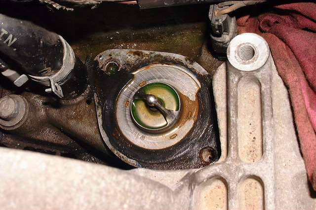

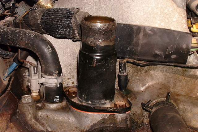

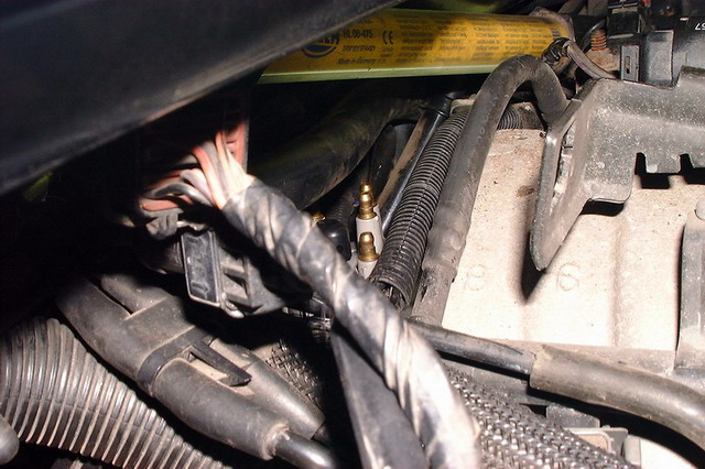

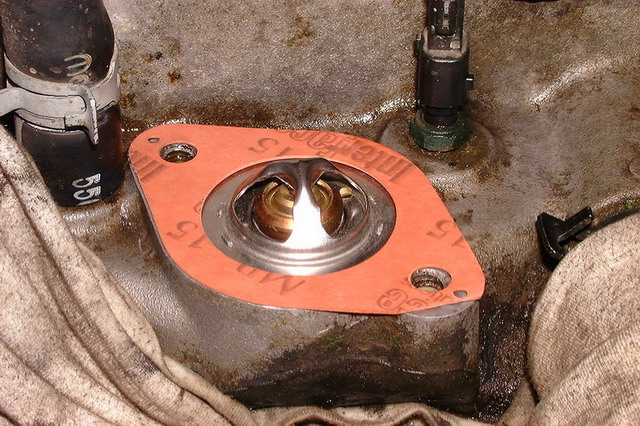

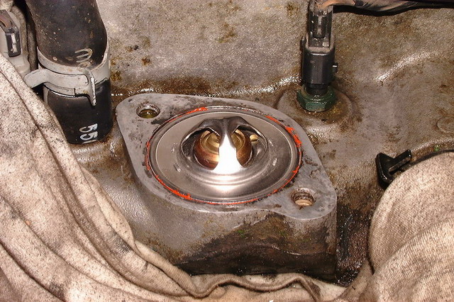

Changing the stock thermos for an 160 unit.
What a (^&(^)(* job to do, eventually took the whole top mounting bracket(generator A/C pump) off to get some clearence.
Here the 160.
With a fresh gasket.
Pipe on and installed the rest of the parts involved.

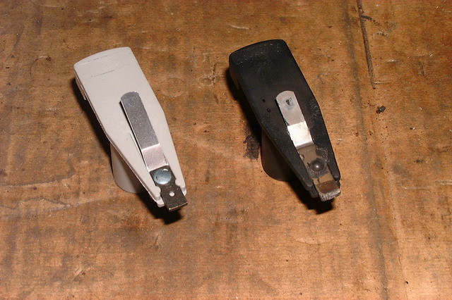

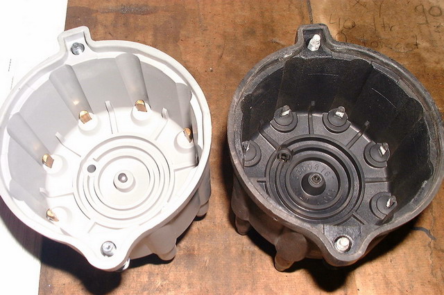

Some electric parts, new distributor cap with rotor.
Doesn't lool like a waste

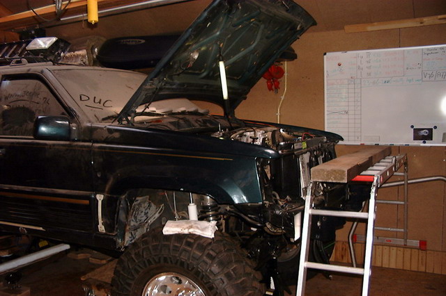

Time consuming job, wrenching in a very small area.
Got it done thanks to a "Wrenching Platform"

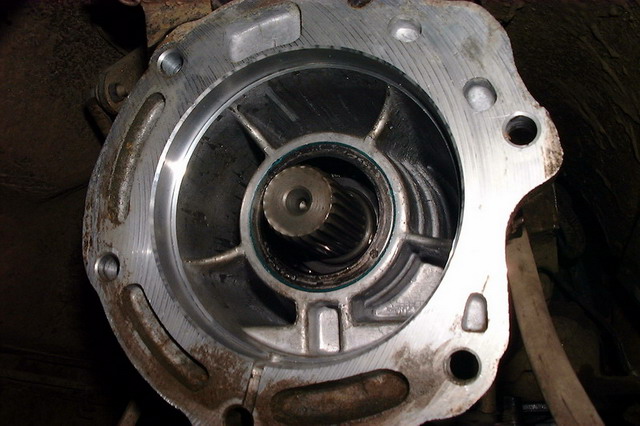

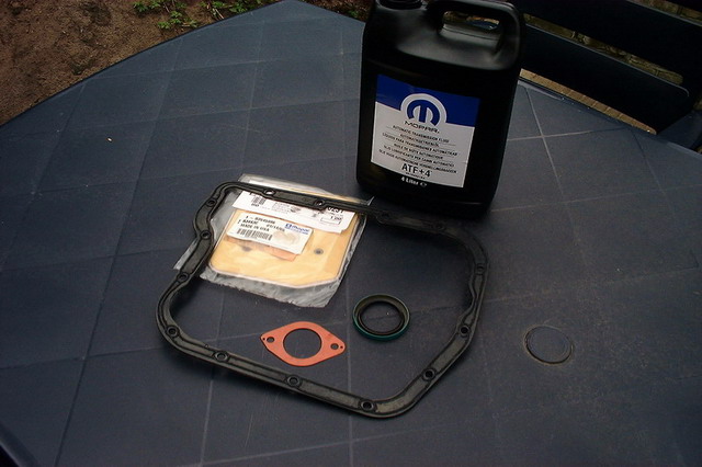

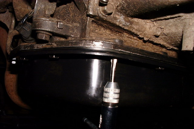

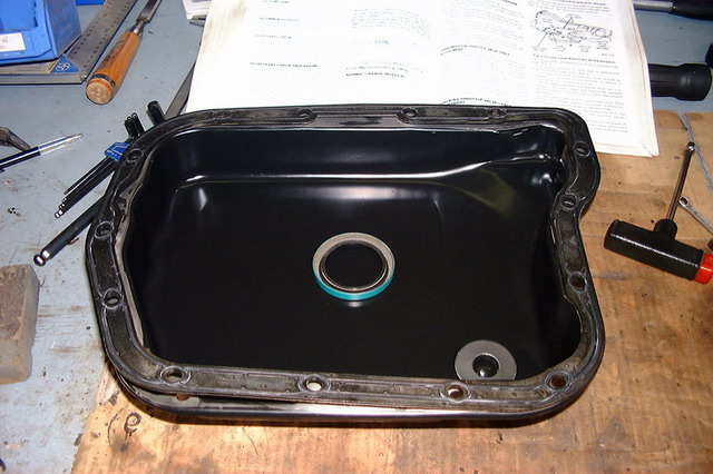

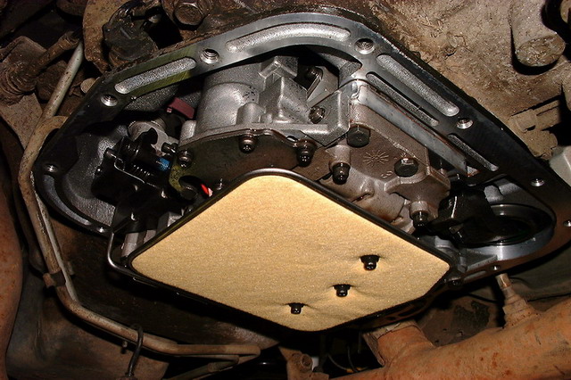

New rear tranny seal and trannyoil pan with new gasket
Unfortunatly a damaged thread in the tranny, damn
Tried to get a heli-coil, but no luck. So tappped it with M8 thread
Very carefully an allenbolt M8 in, not to tight only 17Nm required.

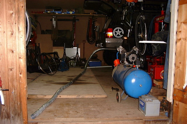

Fabbed up some sort of waste duct.
Result, Big smile (let me translate this for you "It runs again") doesn't need more explaining I guess

An final(for now) underhood view

did you fabricate the duel intake setup, or buy it somewhere. I was thinking of running a second battery setup, but I would have to ditch the K&N I have now.
Thanks,
Dave
