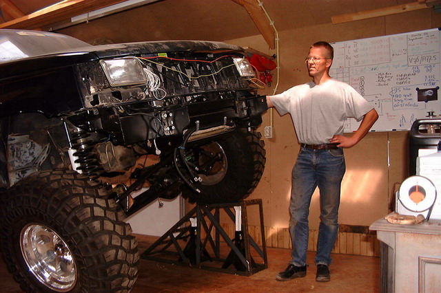

    What have we done lately, well not much.
    After all it is my vacation

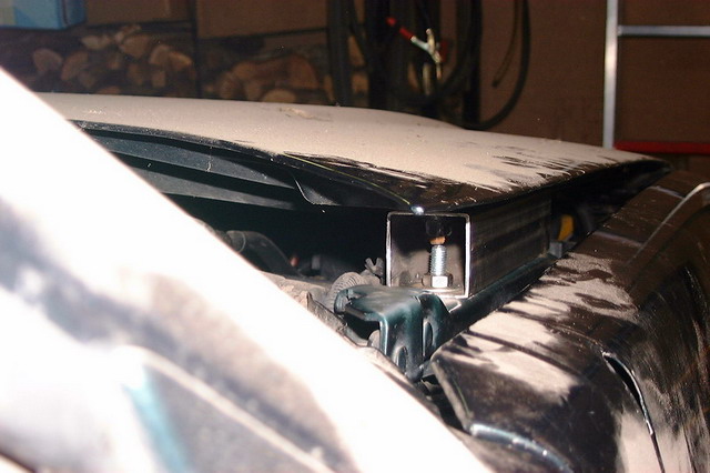

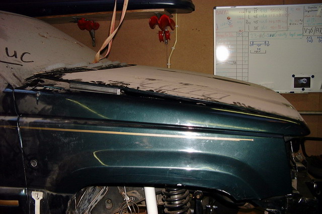

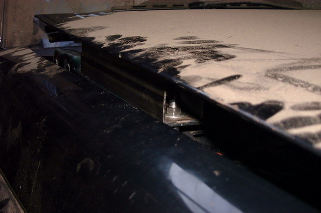

    Earlier this month I "lifted" the hood

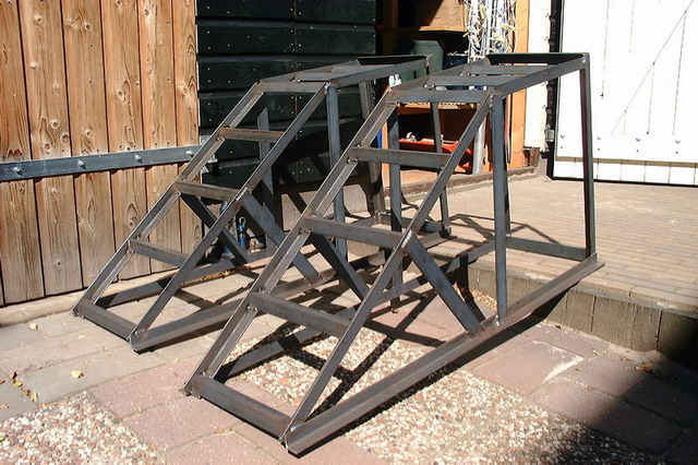

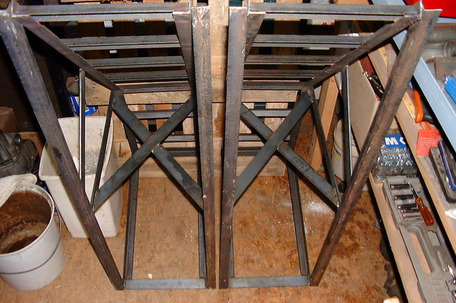

    Used squarre tube for this 40*40*2 220 long, all millimetrs
    Also started on a pair off mini ramps, to help fine-tuning the "flex" later on.
    Used corner 30*30*3 and bar 40*5(all millimeters again)

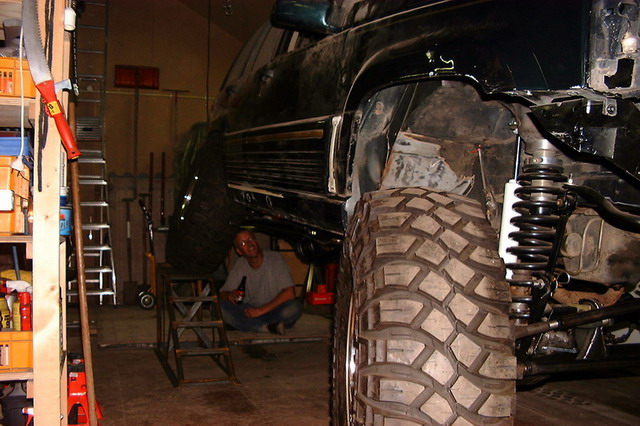

    Tested by Beest, watch the Mallcrawlin.com sticker.
    After some minor adjustments, the final result.

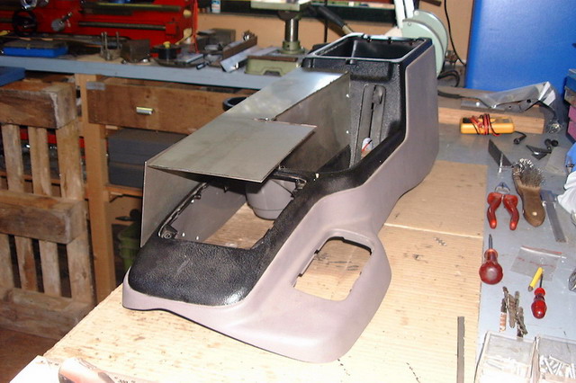

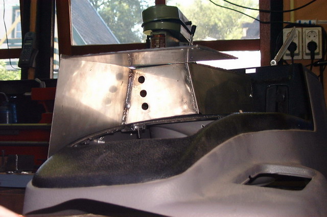

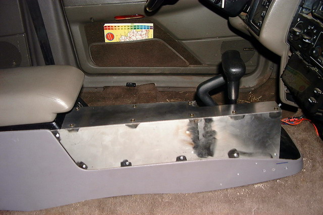

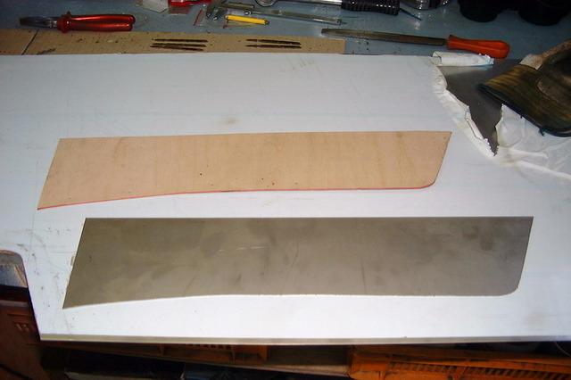

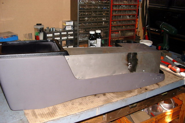

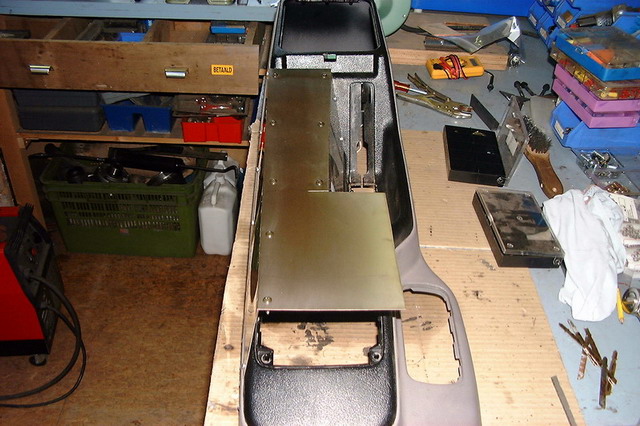

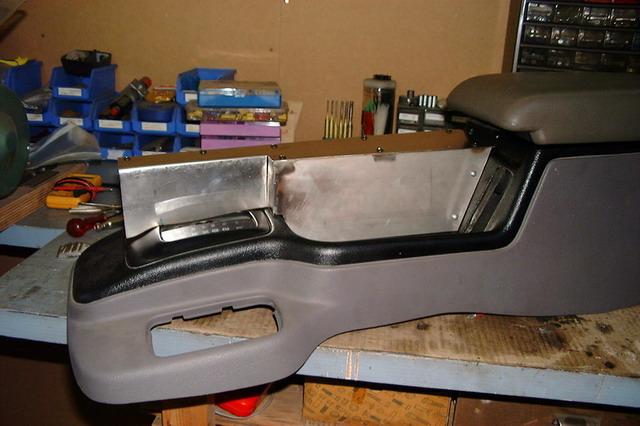

    Because there will be some extra switches and warning lights, I´m gonna adjust the center console a little.

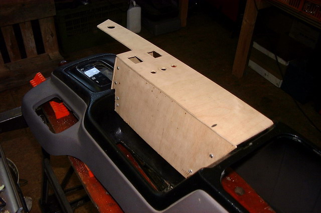

    First in wood, to get some idea´s
    Something like this.

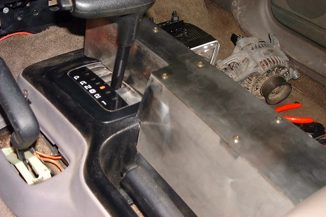

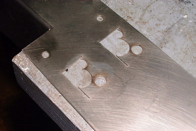

    The passenger side out off 1mm stainless steel.
    In place including the top side.
    After ´bending´ the top piece it will be something like this.
    in the "project".
    That´s right it was hot in the garage today, just a little over 100 Fahrenheit.

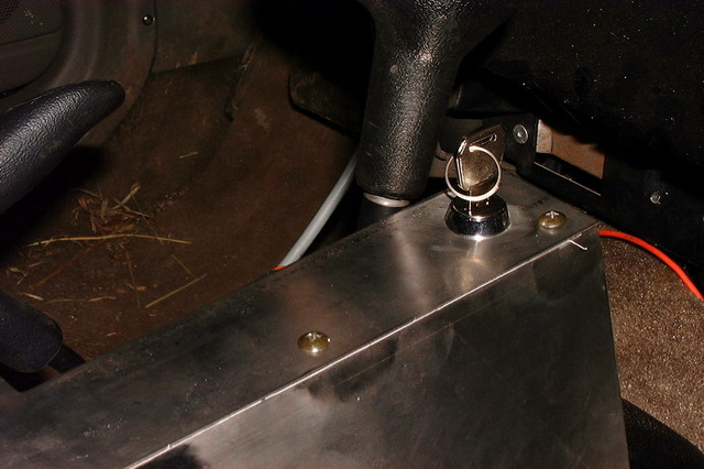

    First attribute in place, winch control lock.
    You never know with small and big children in a jeep toy.
    Have a nice vacation.

    Center console looks trick.

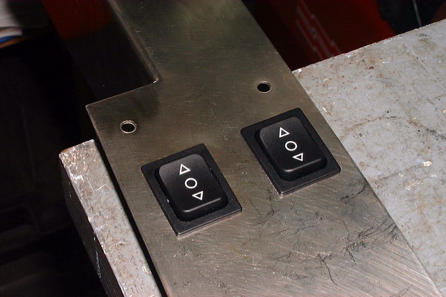

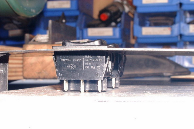

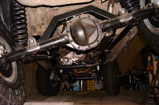

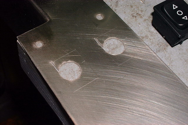

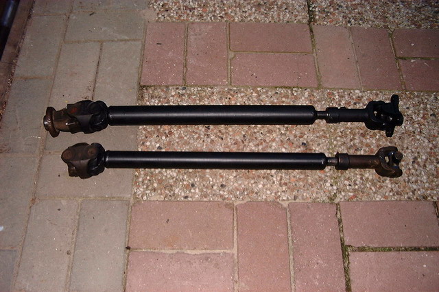

    So it has been a while, but have done some minor things.

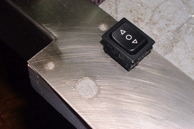

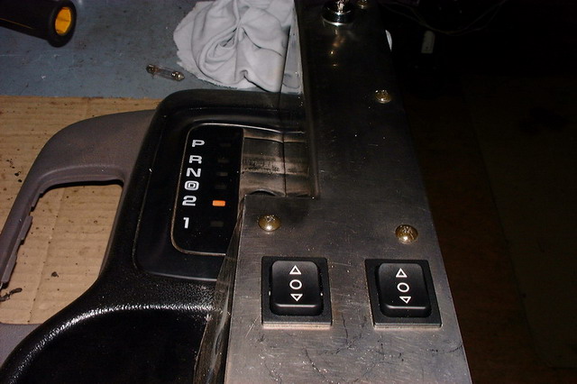

    A month ago I was working on the center console, let's proceed.
    Made 2 incab whinch control switches

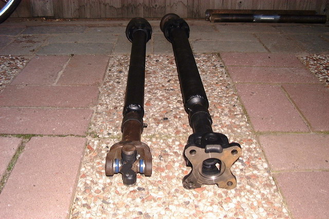

    Major thing however this week was, DS's are done.

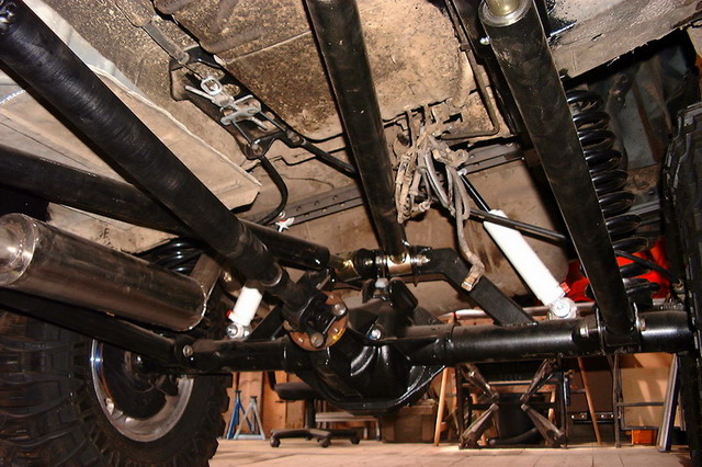

    I couldn't resist so last night I drove it on it's own engine power.
    4 feet backwards and 2 feet up.
    In 2 wheel drive, since the front pumpkin is still empty.
    Don't mind my big smile.
    Next update will be quicker, I think.

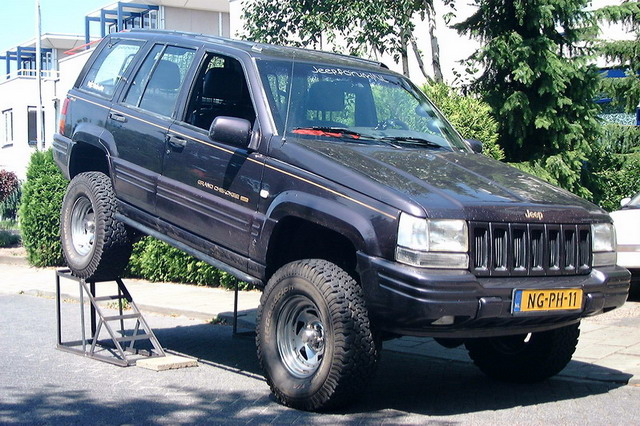

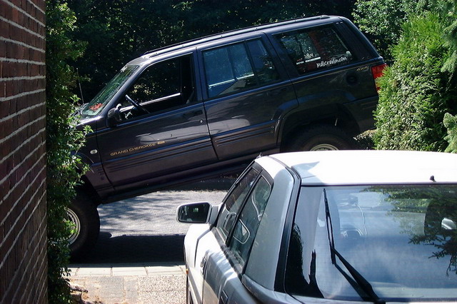

    They won't work well for low cars since the ramp is 38 degrees up.
    They are only 4 ft long and 2 ft high approx.
    Made just a pair for fine tuning on the suspension, seems to work out pretty wel.

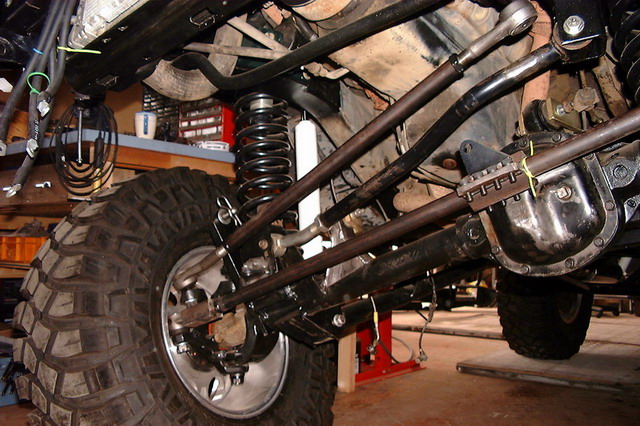

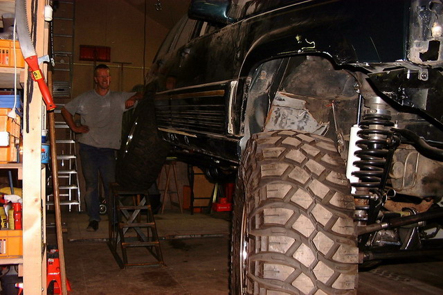

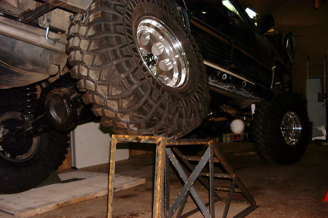

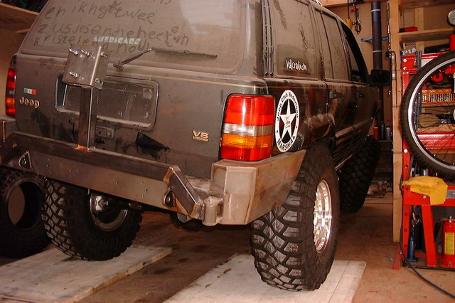

  17. #192 Re: Ogdak's ZJ - Poser shots 08/13/2006
    84

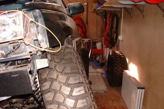

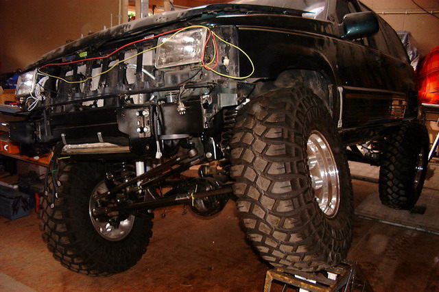

    Quick enough?
    Obvious had to try the front on the ramp also.
    Got the ramp fixed too the ground to avoid it shooting away, so still in 2 wheel drive.
    By the way, I'm a little over 6 ft, standing eye to eye with my left headlamp

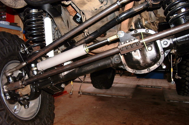

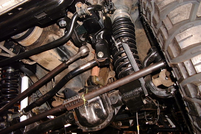

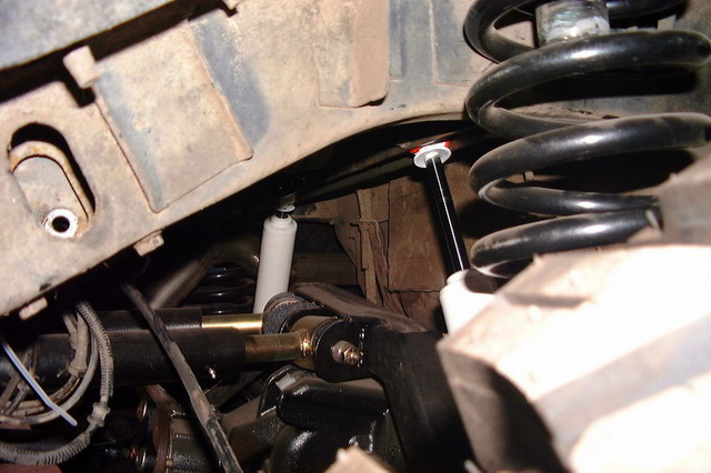

    Enough travel on the rear shocks
    Coils are doing better then exspected
    Little dusty
    Detail

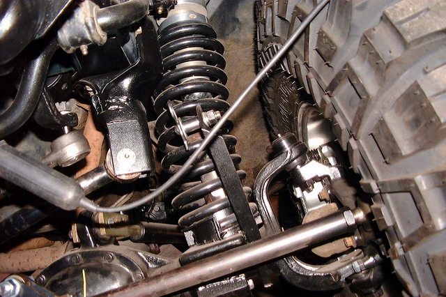

    The hydro assist still fit
    All for now

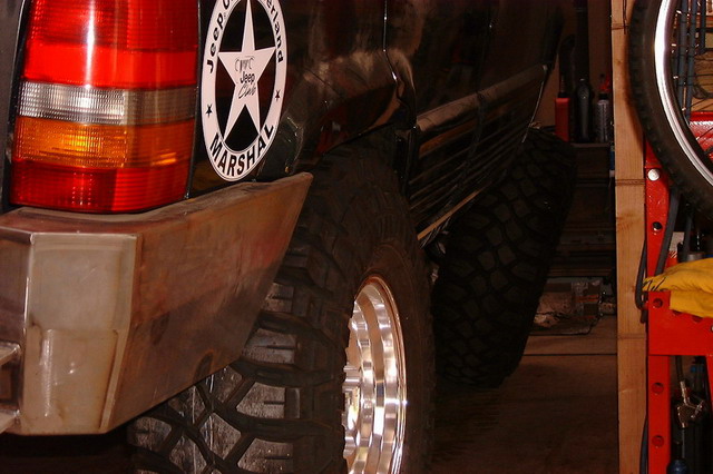

    Quote Originally Posted by violatedppl
    I still think that is the most badass rear bumper Ive seen on a ZJ.
    x2
    Thanx, Sjikita did the drawing and manufacturing off it.
