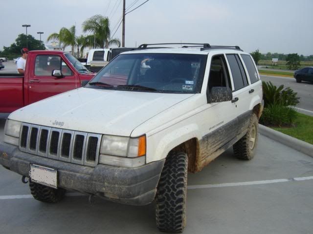

    Well, here's the rig! I bought it back in April '07 with 140k on it, 5.2, 249 (fried VC), K&N, towing package, etc. The P.O. put the BB on it, the BFG m/t's, tire carrier, as well as replaced the cv axleshafts with u-jointed ones. I got lucky, this thing was in GREAT condition!
    I bought it with the intention of keeping it at that state, then I came to this damn site. So to you all!
    How I bought it:
    ________
    First thing I did was, of course, test it out. No action pics, but the results are easy to see.
    With the M/T's and BB, the heep held its own against my friends and their big block trucks on 4"+ of lift, etc. Oh yeah, if you didn't know, there's not much to do in Houston other than mud (except for Spring Creek).
