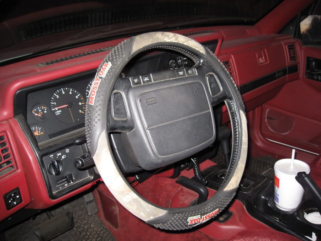

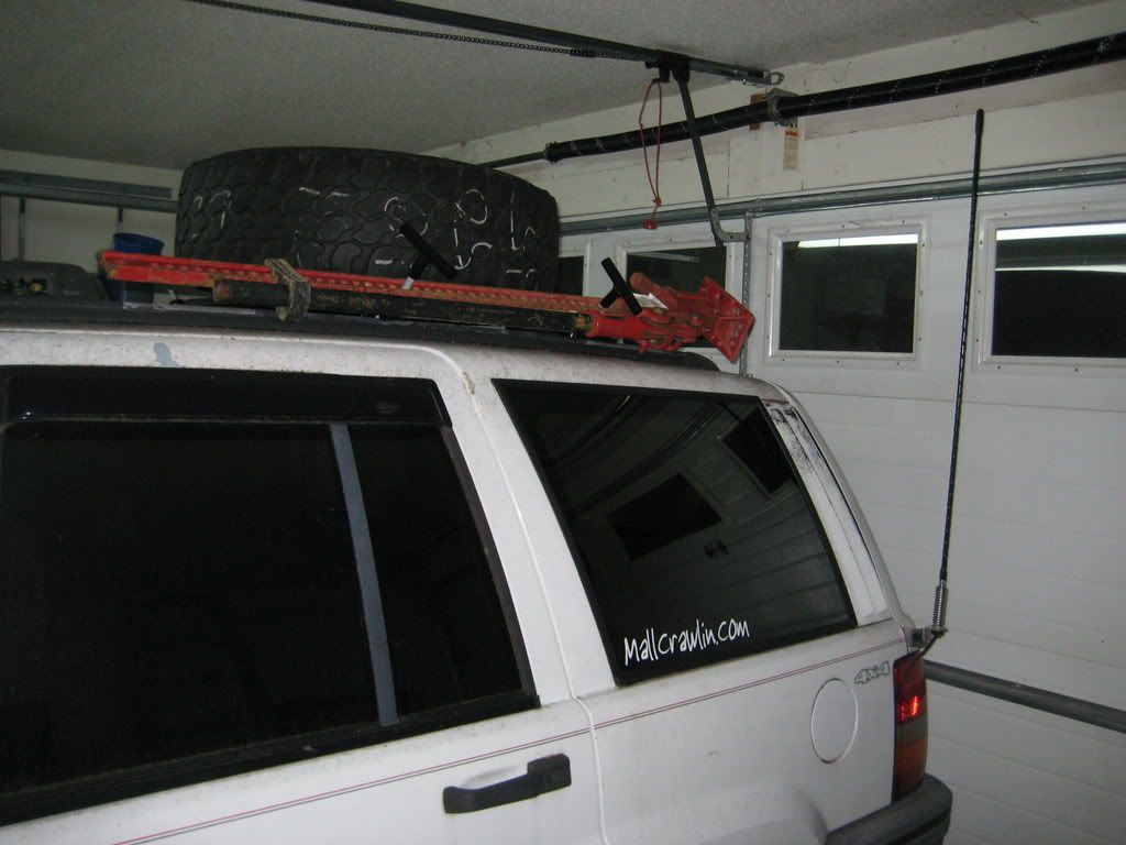

    Well 13 hours and a few cuss words later, the RE 3.5” Superflex lift is on! I didn’t really know what to expect because this was my first full lift I have ever installed. Luckily I had a friend there to help me out. He was more of a CJ guy so we kinda learned as we went. I wanted to take more pictures than I did, but when you get in a rhythm of installing, you really don’t want to break it by taking pictures. Here are the ones I did take.
    We started 8am Saturday morning. Here are some pictures of the ZJ with the OME lift on it.
    I have heard the front is more difficult than the rear, so we started on the front first.
    I quickly learned that this was my new best friend
    We could not get two of the lower control arm bolts out, they were rusted to the rubber and would not budge even after two days of spraying them with the Aerokroil. We had to cut them off and head to the local hardware store to get two new grade 8 bolts and nuts. By far I think the hardest part of the entire install was trying to get the front axle centered. We finally got it close and installed the KOR front adjustable track bar.
    At the end of Saturday we had the front end installed and all that remained was bleeding the brakes. I also didn’t have all of the parts I needed for the front quick disconnects, so right now they are just bolted together, and the disconnects will come later.
    Sunday morning we started by bleeding the brakes, and started taking apart the rear end. I only took one picture of the rear installation because we were really just trying to finish everything up so we could enjoy some of the weekend (out from under the jeep that is).
    I ordered the wrong heim joint for the rear track bar, so for now the stock rear is in there. I am not sure if I am going to replace it because the axle is really not that far out of center.
    We had the rear end together, and after a short test drive around the block I drove the jeep home around 2pm Sunday. The drive home was fun because the steering wheel was all off center, and I felt like I was all over the road. After I got home I changed cloths and took the jeep to get aligned. I was under the impression that the alignment would fix the steering wheel, but apparently not, because the jeep is aligned, but this is the way the steering wheel is turned for the wheels to be straight
    How can I fix this?
    Well here are some after shots. It was getting dark so they are not the best quality. I will get more this weekend.
    All in all I netted two additional inches above the OME lift, so I am sitting about four inches over stock right now. First impressions of the lift are good, and I can’t wait to see how the flex improves. The only drawback is I can really tell a difference on the road, it now feels like driving a lifted jeep. I guess I got spoiled with the ride quality and handling of the OME lift, but I will get use to it.

    you can fix the steeringwheel by taking it to an alignment shop. they will adjust your drag link to re center it.

    nah, don't pay someone else to do it, you can do it yourself.
    just loosen the nuts on the drag link adjustment sleeve and twist it a bit until your wheel is straight again.

    What really suxs is that was the way the steering wheel was after I took it to an alignment shop. I am just pissed they didn't fix it while they had it on the rack. In my opinion I would not let a customer leave my shop with something like that still wrong

    Take it back and tell them to fix it! I had big O align my 3 times before they got it right...and in the end i didn't even pay for it.

    The shop should have done it for you- thats part of an alignment- centering the steering wheel. Unless there wasn't enough adjustment to turn it 180*, but I doubt it. I'd take it back and make them do it right. Did they at least give you a print-out to show what the angles were? Who aligned it?
